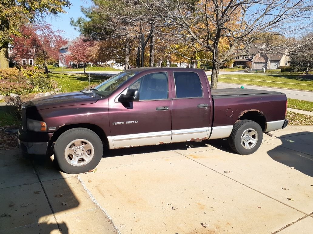

Oh yeah, I haven't mentioned the fact that I am getting 12mpg's with suburban style driving. That's what I got with my '05 with a 4.10 with ALL city driving in Chicago city limits. ...and yes, I realize what accounts for gas mileage. I would expect 14+ in my driving conditions.
I plan on having a final decision by 12/1. If it's sold, it's either a GM (last of the V8's) or new panels on my '05. Right now, this is still my go to truck. ...reliable and always confident when I step on the gas. 180k and still going! That's pretty sad with a new truck sitting next to it.
