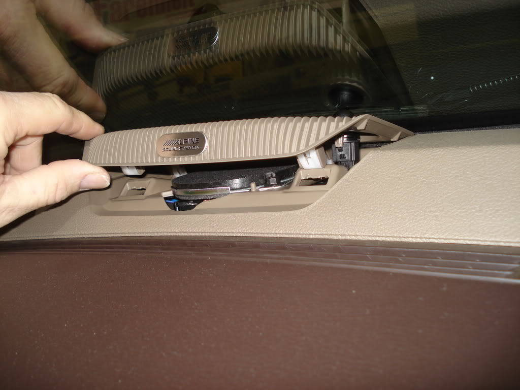

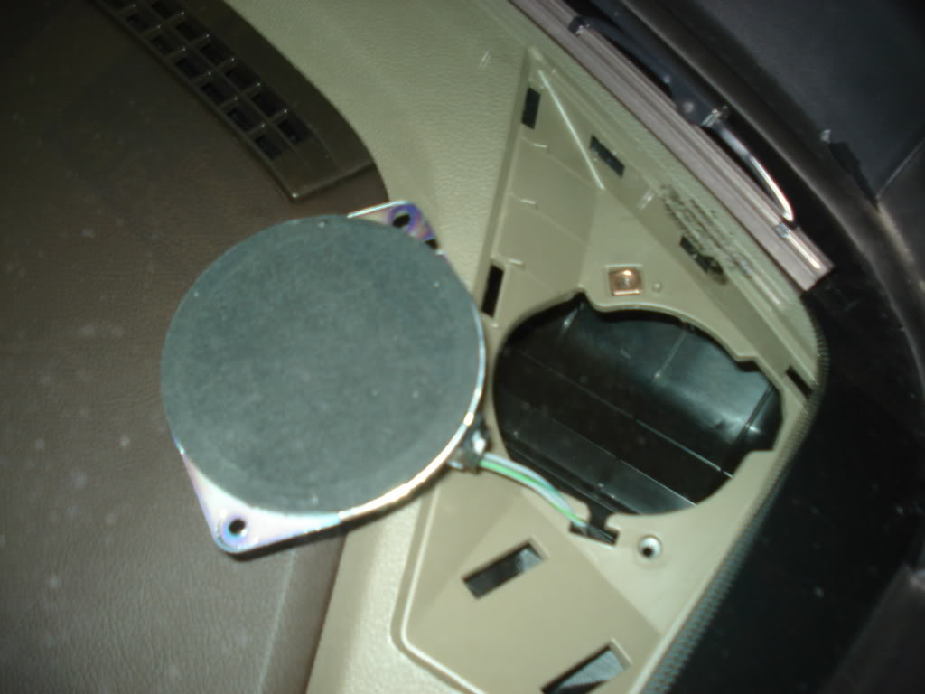

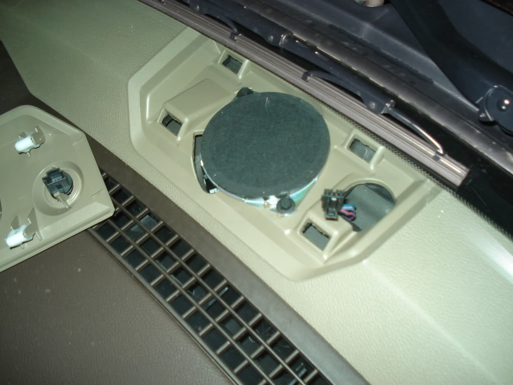

Anyone know what size speaker fits in the center on the fourth gen Rams?? Thanks in advance

The speaker is 3 ½”
And it is a 2 ohm speaker
All the after market 3 ½ “speakers will only be 4 ohm (will be lower volume than the 2 ohm
