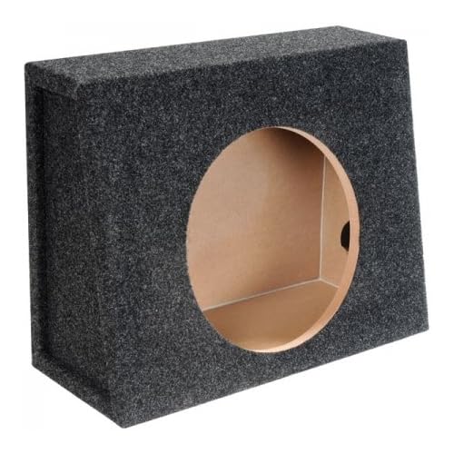

I just got my amp (Fosgate P400-4). I need help from you audiophiles on what type of box to use. I'm going to use two 12" Pioneers but I can't decide if I should use a dual-enclosure like this one:
or if I should go with two single 12" enclosures like this:
If it matters any, I believe my girlfriend already bought two of these guys:

First the foremost, which Pioneer model subs are you looking at? Although they will physically fit the box, will they match the box when it comes to internal cubic inches?
At the same time, if you are crafty, you could easily build your own box. But lets see some model numbers and specs before we start saying it will work.

Heres the dual enclosure:
Total Cu. Ft - 2.4
Per Sub - 1.2
Mounting Depth - 6 11/32"
W - 55
H - 15
TD - 5 1/4
BD - 8 1/4
Here is the single enclosure:
Product Features
Sealed Truck Enclosure
MDF Construction
Completely Carpeted Enclosure
1-inch Speaker Baffles
Screwed Down Terminal Cups
Technical Details
Brand Name: Atrend
Model: E12ST
Total Cu. Ft - 2.4
Per Sub - 1.2
W - 55
H - 15
TD - 5 1/4
BD - 8 1/4
Product Features
MDF Construction
Technical Details
Brand Name: Atrend
Model: E12ST

I didnt see anything specifying otherwise so Im taking it these are single VCs. Looks like you are kinda meeting in the middle on the internal cu in/cu ft so thats good. That leaves room for poly-fill if you want to add some. Mounting depth is good.
I dont like the power ratings of that amp v/s the subs.
