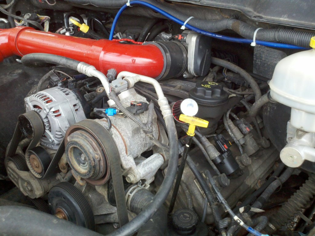

I went with a Maniac Electric Motors 160 amp for my truck, which I ordered and installed at the same time I did the flexalites. It was my first alternator swap and only took me an hour to complete:
