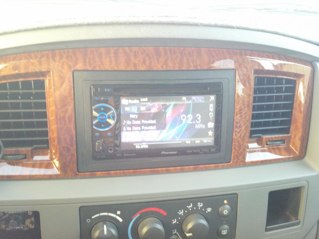

I decided to put a new system in the wife’s 1500 Quad Cab – and here it is.
It originally had the factory 4 speaker system with standard head unit.
I installed the following:
Pioneer AVH-P2400BT (double din)
2 Kicker 10C104s (4 ohm)
MBQuart FX1.400 for subs
Purchased a used MTX Thunderform for under the back seats.
Kenwood 5 ¼ 2-ways in all 4 doors (will run on HU power for now)
(Phase 2 will be adding Kicker 6 ½ to all doors along with baffles and a MBQuart FX4.50 to run them)
More details:
Purchased a new Nav Bezel on line – paid $252 for it!!!
Purchased the following from installer.com
Metra install kit 99-6510
Antenna adapter 40-CR10
Standard wire harness 70-6502
First: removed all seats and center console to make things easy.
I ran a fused 4 gauge power wire from battery through driver-side firewall and under carpet next to center “hump” to the amp, which is installed under the rear seats.
For the “Dimming” lead from the radio, I spliced into a wire that was leading to a small light in the center console (maybe for what was the ashtray?)
Ignition switch wire – this is a problem. All I can find (after searching the entire 100 pin canbus) is a 12V lead that comes on when the key is moved to “start” position. I wanted one that works when the key is in the “accessory” position. Maybe if I had purchased the canbus adapter from Metra, it might have worked.
Nevertheless, sounds fantastic!! Enjoy the pics.
