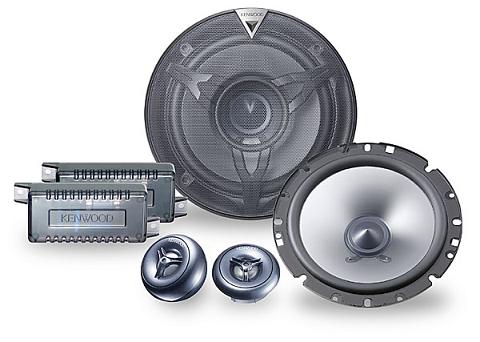

Hmm, well I plan on getting a Kenwood KFC-P705ie component speakers for the front doors. It looks to me as if they have both 4 tab and 3 tab styles.

Well those look like they likely have the right hole pattern, but they won't seat properly, on the three tab style on the one I had there was raised plastic tabs directly to each side of all three tabs, the speaker tabs would fall between those, on that one you posted the mounting ring would hit those tabs before seating down properly on the hole, you would have to remove those tabs on the car to put those ones in, if I remember correctly the part in the car is just a plastic piece that mounts to the steel door so it would be easy to remove the tabs with a file or dremel, I had used 5 1/4 speakers on mine and made an adaptor plate so I didn't really have an issue with mine.

Oh, so you think the plastic adapters on the car will be fairly easy to remove? The only way my dad will let me order all these off the internet is if I use one website, so I'm going with onlinecarstereo.com. I'm trying to get some nice 6-3/4" component speakers for the front doors, which there aren't a lot of. I have a question though, do you think component speakers are worth it?

Yeah, it should be simple to remove those tabs, just file or a dremel them off, I only didn't because I knew I wanted the cambridge soundworks speakers and they only made them in 5 1/4 so since I had to make an adaptor plate anyways I just made the plate to fit inbetween the tabs.
2 Channel to two subs you mean and the component speakers to the headunit's amp? yeah, if you have a good headunit that can be fine, but it definatly does vary from headunit to headunit, some have horible built in amps, others have pretty decent ones, that's actualy how I have mine setup currently, component speakers to the headunit's amp and subs to a seperate amp, for the subs though you would be better off getting a 2ohm stable mono sub amp and wire the two 4ohm subs in parallel to the amp.
