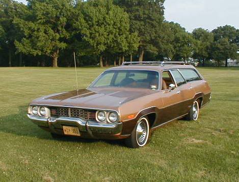

Hello all. I have a 1972 Plymouth Satellite Regent 9 passenger wagon my grandpa bought new. It has a 318 with a 904a tourqeflight. It has been used since new to haul and tow, as a wagon should. Now 30 some years later the trans is on it's way out and I'm looking into the TCI street fighter 727, as I know it is a stronger trans in stock form. I'm just not sure if it'll bolt directly into the car. Is the case the same length? Is the trans crossmember mount in the same place? Is the trans yolk on the drive shaft the same?

Well, the pic is a bit more flattering than the car in person, but it's not to bad for a all original car. Just has about a 2"x2"patch of rust on both sides where the dog leg meets the rocker.
