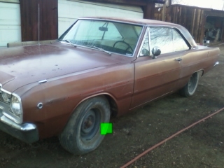

Cool, thanks. Had been a mechanic by trade for over 13 years. Done mostly offroading stuff other then the usual gravy servicing. If interested, check out my site... www.hinlodesertrunners.com
That's our offroad/camping site. Been a Toyota, Samurai, Ford and Chevy tech-dude all my life with little Mopar experience. So any help is appreciated. Especially with my new found baby! I am falling in love with this car. It runs perfect right now with the 2bbl and the 273. It has 58,443 original miles, engine, trans, the whole shebang! But, wanna "pickle" the engine and drop in the 360. Sorta go a little retro stock car look on it a little bit but not change the vehicle's overall original integrity, if that makes sense.
Here is a pic in her current state, with the trim removed for repairs...
Anyway, thanks again!
