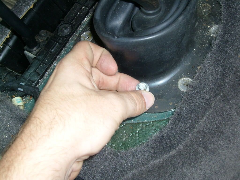

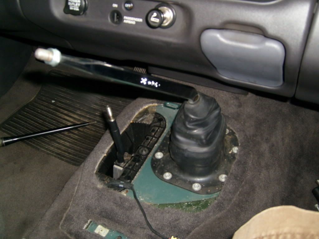

Next you have to remove the heat/dust shield that is around the bottom of the stock shifter. (pic below) There are 8-10 8mm bolts there that you have to unscrew then there was some type of glue holding it on so i pryed it off with the flat head. It then just slides off as you can see on the second picture below.

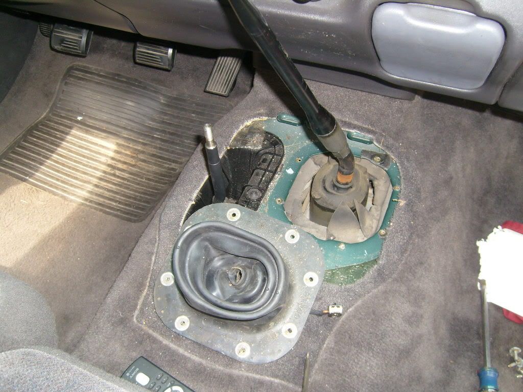

As you can see in the pic below as from the pic above i removed some of the fabric stuff that is around the shifter so i didnt get any of it in the tranny when i took off the old shifter. There are then just the 4 8mm bolts that you remove and the stock shifter is out.

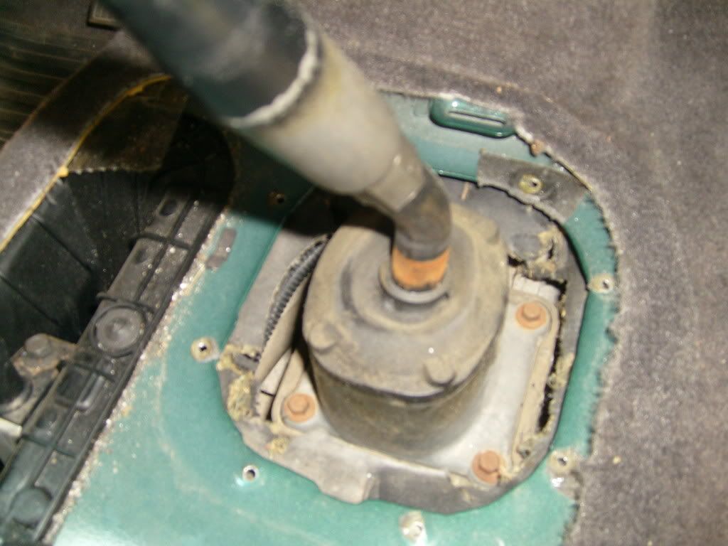

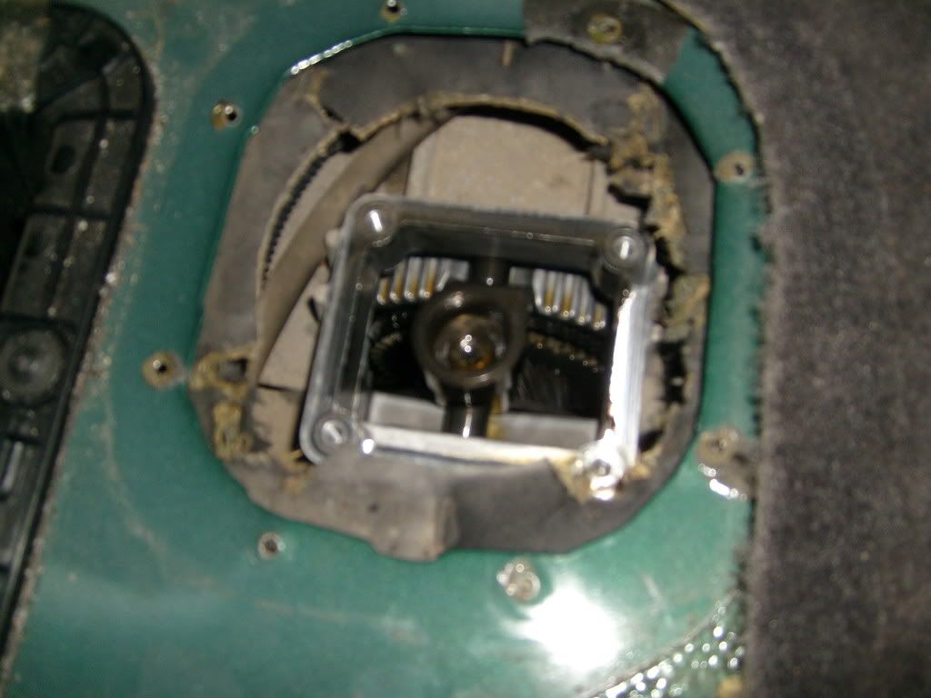

The picture below is of the top of the tranny once the stock shifter is out. That thing in the center is where the ball on the bottom of the shifter goes.

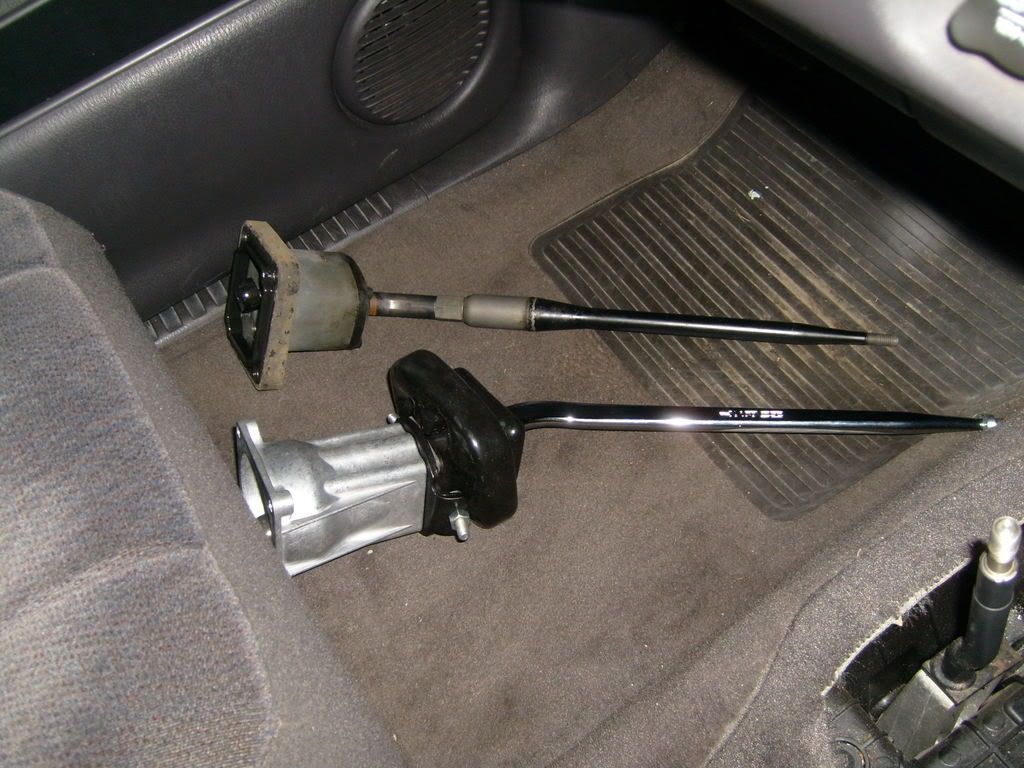

Below is a picture of the stock shifter and the Hurst shifter side by side. As you can see the hurst shifter is a lot more sturdy and sexy. The bolts on the front and back of the Hurst are the bolts so that you don't over shift a gear. You just put it in second and screw the bolt in till it touches the shifter stick and then tighten it down and then do the same in third.

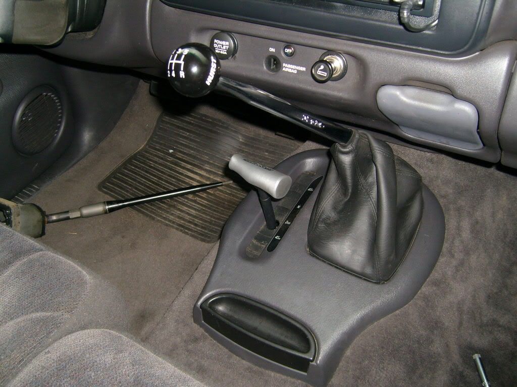

And below is the finished product. I put the console back on bolted it up and put on the hurst ball and t-handle onto the t-case. Below this pic i'll describe my reaction and how i like it.
The Hurst shifter is so much nicer than stock. It didnt take me to long to figure out the new throw and shift points and overall I love it. It feels just so much more precise and solid and doesn't seem to clunk into gear. I am doing my tranny fluid soon and hope that gets rid of some of the clunking i still have. It is a little noisy and you can hear the gears due to the fact that its all metal compared to the stock one that just seemed weak. I highly recommend it too anyone who wants some more performance out of their truck or just for it to shift a lot smoother and more precise. I got it for $180 from summitracing.com because i got a get $30 dollars off a $100 dollar purchase and it was def worth the $180. HIGHLY RECOMMENDED to anyone with a 94-00 5 speed Dak. I believe i got everything i'll probably read over it and revise it a little but im pretty sure i hit the main points let me know if you have any other questions.
