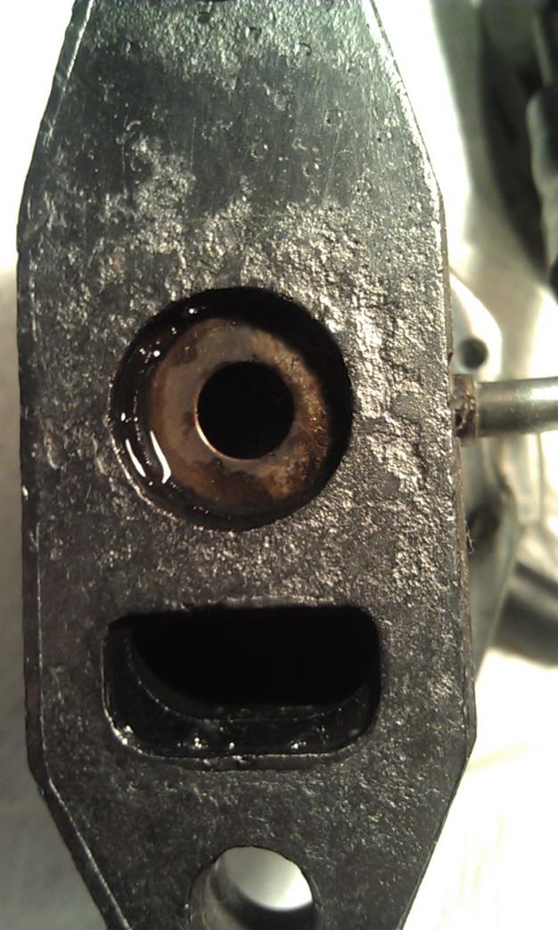

Sorry so it’s a 2.5. I took the EGR valve off and it appears to be pretty clean. See picture below. I am wondering if it’s open. I am able to blow air through it when blowing in the round whole air comes out the square whole. If I disconnect the bottom hose on the EGR vale air flow out. I would be talking about the VAC hose that connects closes to the engine just above where EGR valve connects to the engine. But prior to taking off the engine ran fine. From my understanding the engine would stall and die thought if the EGR valve where open.

sorry forgot to add the picture.

low flow is normally blocked passages or the valve not opening / opening fully
yes wide open it can cause stalling / bad idle ...
the weird thing is I've had my EGR blocked off the rear of the manifold for years and never get the code
So the code must be valve related
I'd try flushing carb cleaner thru there

I have it submerged as we speak right now in some carb cleaner hopefully that will resolve my car problems. I found a tin can to submerge just the valve. One site I found suggested doing it overnight which is my plan. Thanks for the input and help.

So after letting the EGR valve soak overnight and installing the next day. It died a few times on my way to work. But after work I was able to drive it home yesterday and today also without it dying. It idles fine also no skips or miss fires that I am able to hear. So just maybe the EGR valve was clogged up inside.
