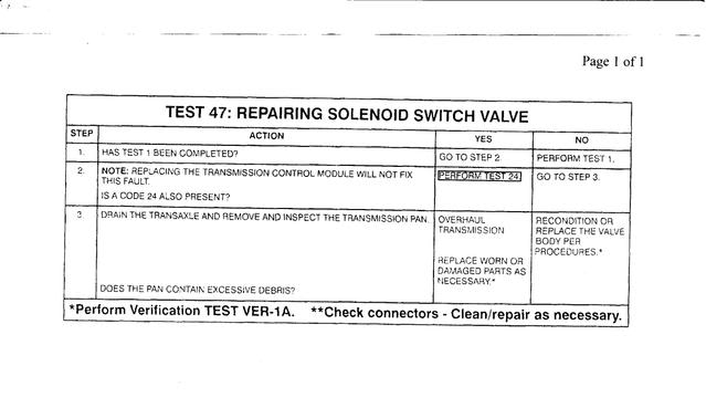

Recently while coming off of the highway my tranny went into limp mode.
I checked the codes and got an"obd2 - 1776" -aka- (i think) a dtc-47 -
Which is, "Solenoid switch valve latched in LR position".
No other codes came up at all
just a generic p0700- transmission control system malfunction.
Ive read that if a DTC 24 comes up then its electronic and if not then its not.
By what Ive read about the 41te and this code Im guessing that since my vehicle has 152000 miles on it its probably the SSV getting cockeyed in its "chamber" just due to normal wear..
Im planning on just replacing the valve body.
AM I ON THE RIGHT TRACK ?????

If your going to guess I would try replacing the solenoid pack.
There isn't much to the valve body on these transmissions.
Doesn't your buddy with 30 years of experience know how to diagnose properly?
Look up P1776 on Alldata and read the code description and fault parameters.
It should point you to a diagnostic tree that will tell you how to properly test your trans for the conditions that cause this code to set.

well i brought her to a good tranny shop just in case i was wrong about my diagnosis. I didnt get any codes except the 1776 and according to alldata that means one thing without other codes- a valve body... the shop replaced the soleoid pack. Ive driven her on the highway and all around about 3 hours driving so far and so far so good.. im impressed. I will keep you updated if i have any issues from here on out.... Thank you all for your comments...
