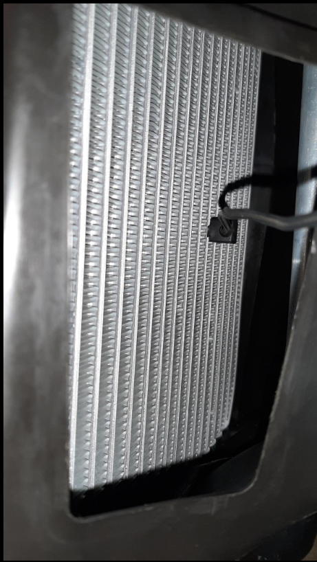

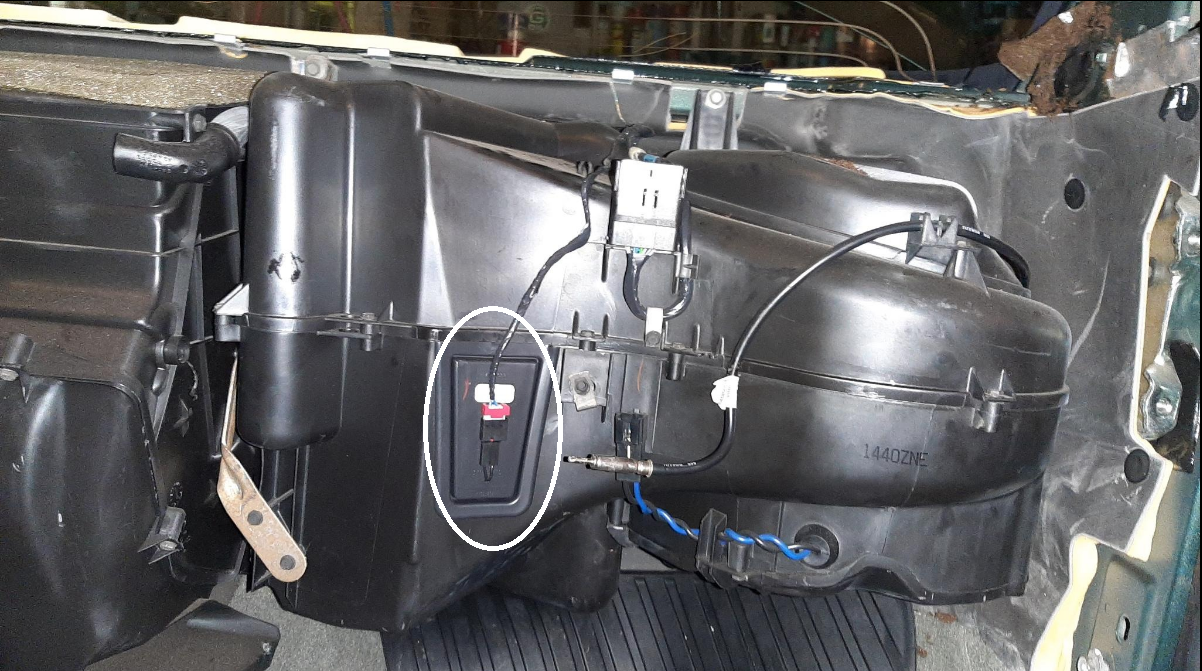

Luckily on the 3rd gen NS vans, access to inspect and clean the evaporator core is pretty easy via the temperature probe cover, which pops off and on easily. This enables cleaning the core with the aerosol cleaner you mentioned. It also gives me the idea of using a regular home a/c foam filter if I can figure a way to attach it.
The evaporator probe cover behind the glove box gives access to the front of the evaporator core. The temp probe cover is just held in by a rubber gasket and can be popped in and out easily. Access only requires removal of glove box door, which is easy.
Inside the evaporator probe door there's a clear view of the evaporator core. This is the new core I installed.
