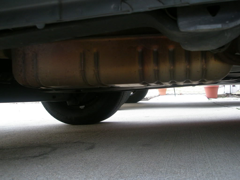

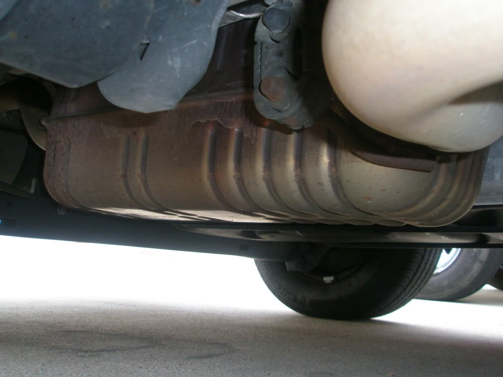

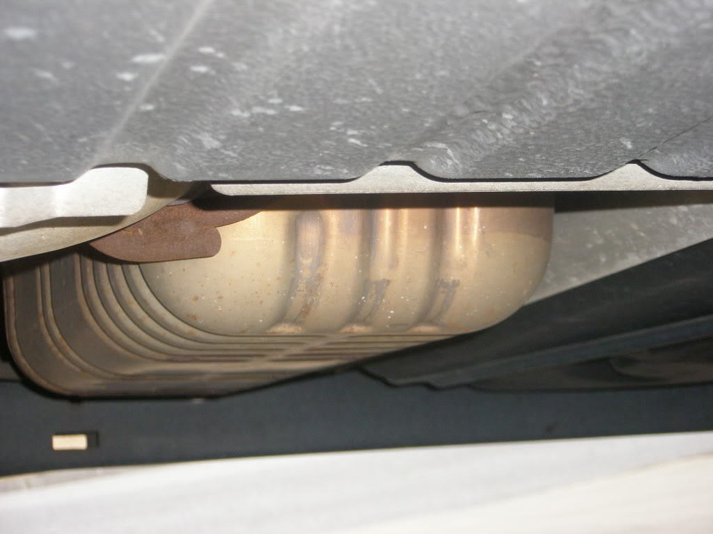

Yesterday my mom's 06 Grand Caravan started leaking water Under it. Trying to figure out what my be the problem and what this is it looks to big to be the muffler so can some one help me?

It may be the rear heater core lines.
Is the coolant level dropping?
What color is the fluid being leaked?
What does it smell like?
The only "water" type fluids would be;
- Coolant/ anitfreeze
- AC condensation
- Window washer fluid
With rear heat and AC, there hard lines running under the van to the back.
The washer fluid also runs to the back.
Has to be one of them.
Best to jack it up (chalk the wheels and use jack stands), and get your drop light and take a close look.
Monitor the fluid levels closely.

Fig. 2 - Exhaust System - Typical - LWB
1 - CATALYTIC CONVERTER 4 - RESONATOR 2 - BAND CLAMP 5 - INSOLATOR 3 - MUFFLER
Old Mar 2, 2010 | 05:29 PM
Tizzy1's Avatar
Tizzy1
Joined: Jan 2010
Posts: 3,023
The hole in the muffler is to drain the water so it doesn't corrode. They can drip quite abit and it is a common leak complaint.

But i never noticed it before.

When you have time, take the van for a spin and then let sit.Watch and see if the water dipping from the exhaust or the rear coolant hose's.
