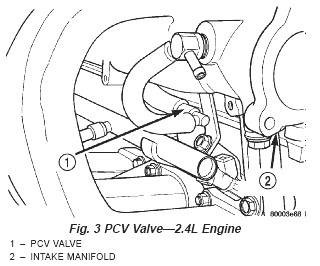

Hi,
I want to change the PCV Valve on my van Ive done this on other cars before but I can't find it on this van! Can someone tell me where to find it or give me a diagram? Other sites I looked at say that ther could be 1 of 2 types 1 that screws in and 1 that plugs in... I am obviously missing something.....
Thanks in advance

From the FSM:
Attached Thumbnails 2000 dodge caravan 2.4l PCV Valve-screenhunter_01-oct.-10-05.28.jpg

Thanks a million mgbmike!!!!
