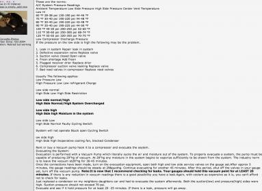

Temperature varies according to humidity and outside temperatures. See attachment, forget the psi numbers your not trying to check pressure. Hope attachment opens, i never tried this before.

See if this attachment becomes larger if not i will try again and write numbers down for you

Can't give exact temperature b/ outside temp. and humidity not know. So there goes. Sorry about attachments, my original is just too small. I will assume summer time temps
80 degreee--43--48 from vent
90--44 to 50
100 52 to 60
110 68 to 75.
It was quicker to write them down then try to send attach. should have did this first, but wanted to explore.
