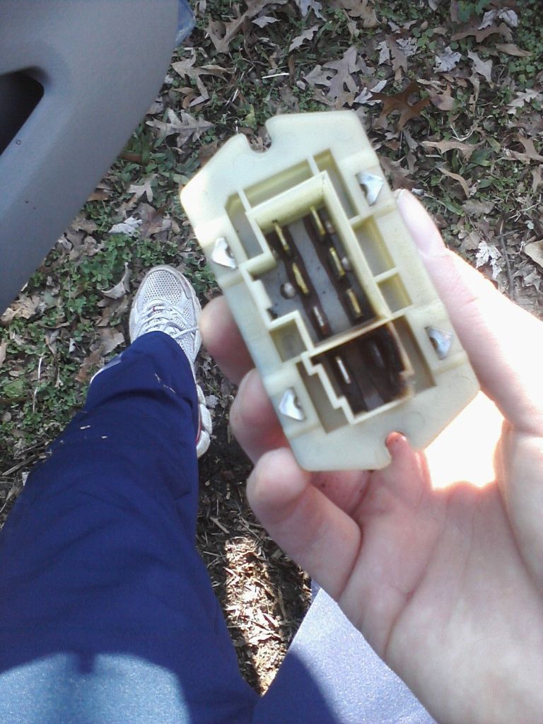

Well it was the resistor and resistor connector. Seems as though the resistor is bad, but the big problem was the fact that the positive wire going from the blower motor to the resistor for the on off control on the resistor had corroded and shorted out, causing the pigtail to melt.
Going to take 3 days to get the new resistor and no one has the dang pig tail. Now my question is, I have a connection now and the blower motor turns on high. and only on high (bad resistor) however, seems to only blow cold air now...wth is this caravans problem?

I changed the resistor tonight (they managed to find one). The only resistor that matches my plug in was the resistor that is apparently for the Caravan with the aux. rear AC...This van only has controls in the front..so not sure what is up with that.
But anyways, I took spade connectors and connected the wires directly to the prongs on the connector for the on/off switch. Looks like it is working just great!
BUT, a problem still persists. When driving, oh man do you get some nice lovely heat, after driving, you have heat for a few minutes while idling. But, you turn it on defroster, or want heat before hitting the gas, or idle for too long, its not so great heat, and defroster is just chilly.

Picture of the old resistor below.
