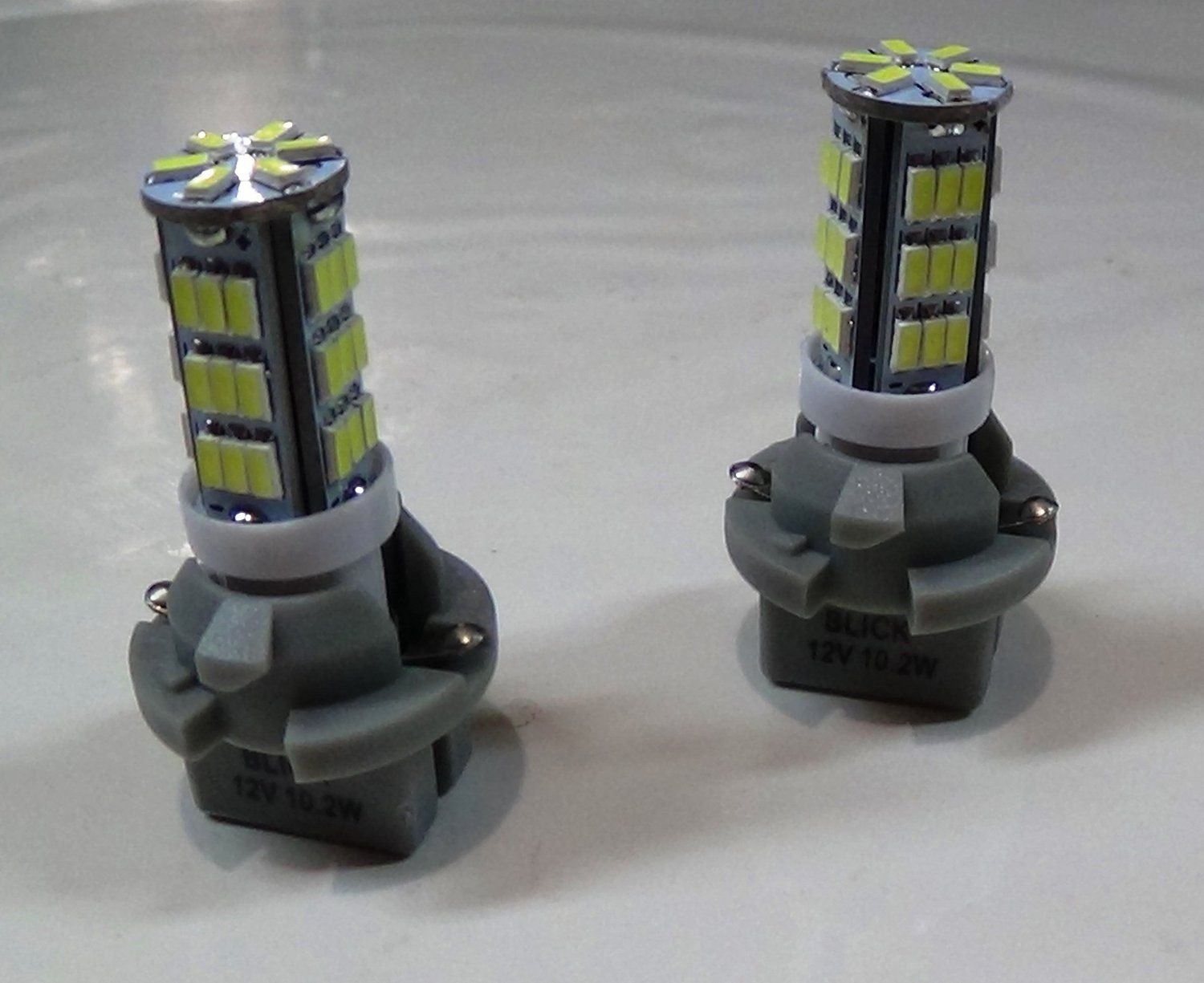

An update on the PC579 'headache'.
An avoidance of the excessive heat & burn from the original PC579 caused me to do this.
I have purchased a pair of these T10 replacements:
http://www.ebay.com/itm/4x-White-Sam...pXNRBC&vxp=mtr
which use the new Samsung 3030 LED's and produce around 280 lumens. They are a bit on the "Blue" side for my taste but they are the best I have found for the transformation.
You need to do the wire-removal and swap the bulbs, but for less than $5 per light you get almost twice the light for 1/2 the power & your passenger will be impressed.
Cheers
