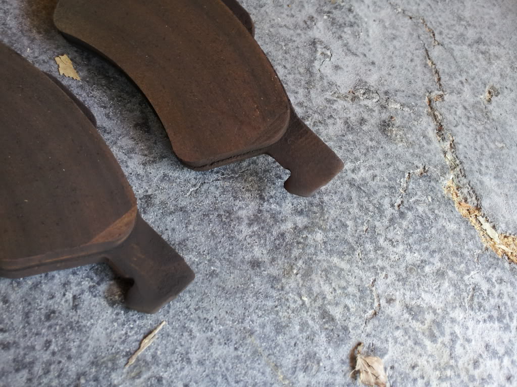

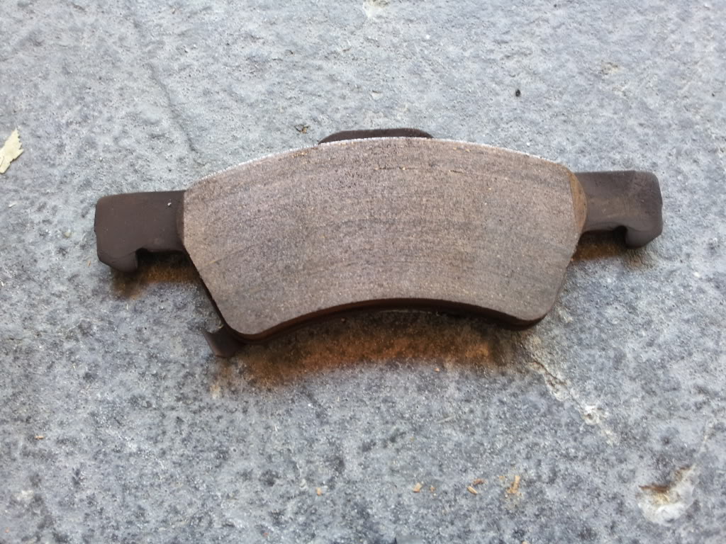

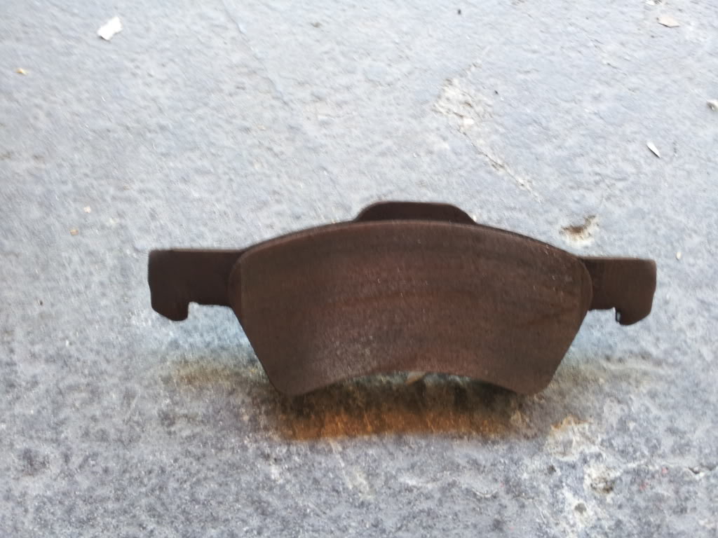

Finally opened the front brakes. Passenger side is ok with 80%. Driver side is also 80%, but the edge are worn out. What could be the problem.
The corners are not worn out, they are tapered when they are made. Look at a new set fresh out of the box.
