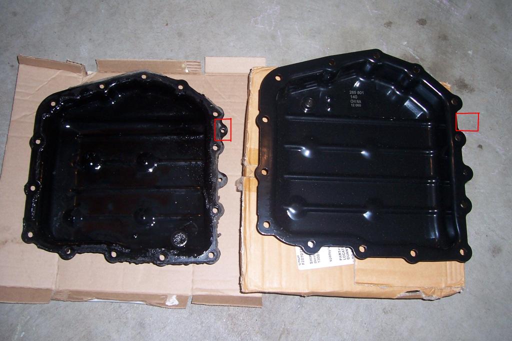

Dorman trans pan 265-801 can be used for models that it says don't fit
the exact fit is only up to 02
for my 06 here is the only difference
one less bolt hole then the original (holds an electrical connector)

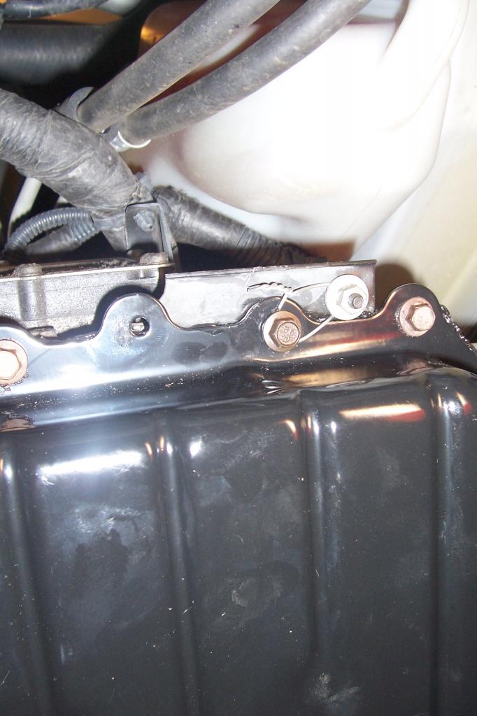

here the electrical connector with the attached stud showing

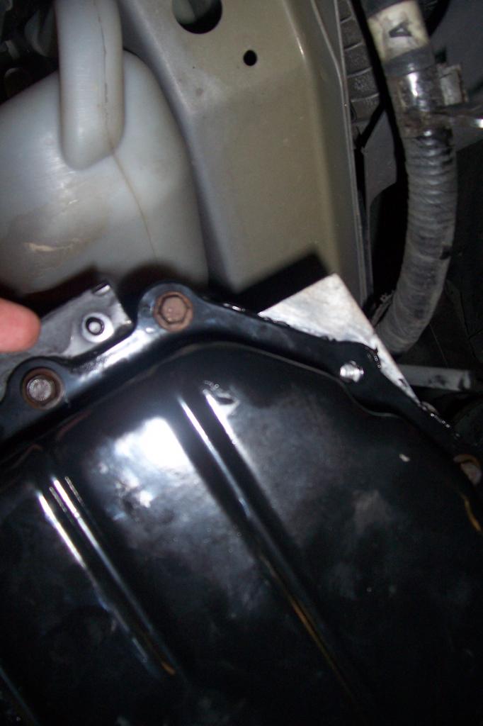

I just ran some wire around the stud and another bolt since there is no real weight being held on

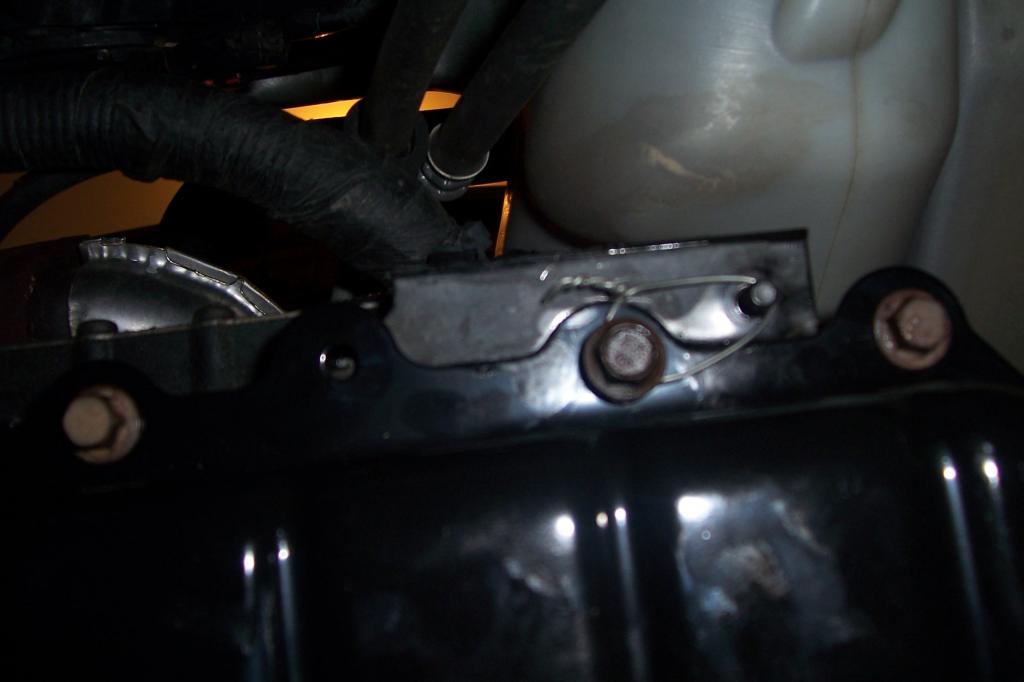

after I put the nut on,(don't mind the empty bolt hole next to it)

Looks okay. But you could have run a piece of metal, one for the bolt hole (use a longer bolt) and the other for the connector. That may look like a cleaner job.
