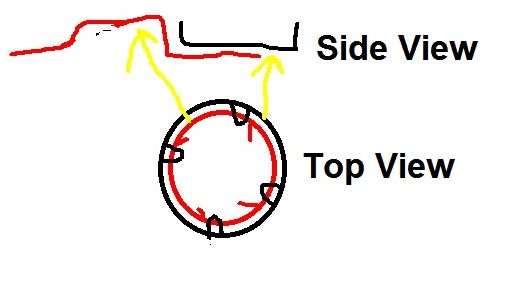

I have a 2007 dodge caravan, 3.3L gas (VIN "R") engine.
I am having a problem removing the lock ring holding the fuel pump in.
I can rotate it CCW about 1/8 inch, but it looks like the tabs need to be pushed down at the same time it is hit.
I have approximated things on the attached drawing.
How do I get this ring off?

I hit it with a dead blow hammer and a brass punch. A couple of nice hits and she comes off.

If you take a look at the picture, I have tried hitting it
at the tabs where the red x's are (but on all 5 tabs)
Should I be hitting it where the green marks are?
(I don't want to break it, as I can't find another locking ring around my area,
no Amazon, No RockAuto.

I got it off!.
It took some very hard hits.
5 lb hammer.
