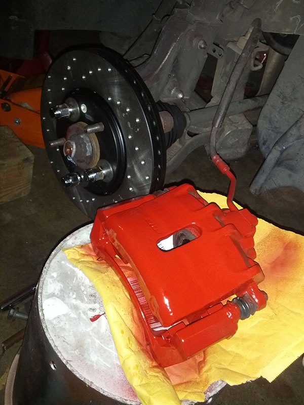

Tire Rack has a chart with stud sizes and it says 85# for 12m - 1.5. I guess I'll go 90 for good measure.
Work in progress I'm waiting for the pads. I have been doing lots of reading and from what I see drilled is for show only and may hurt heat sinking and the like. Geesh. Hopefully with the so-claimed better metallurgy, Cryo treatment, maybe I'll get lucky. She will have the Bling without the Zing eh?
I have the rotors bolted on to indicate them. The needle barely moves. I would have to put a last word indicator on it to get a number. Looks like I got a true set.

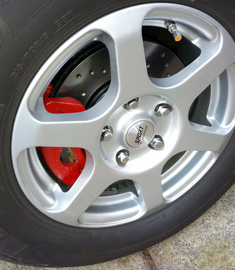

Default They Are On "Bling!"
Well she is back on the road. I wonder how many Minivans one will see like this?
Now I'm gonna drive her as usual and if they warp or transfer material I'll be back. I did the burnish and she is good to go.
