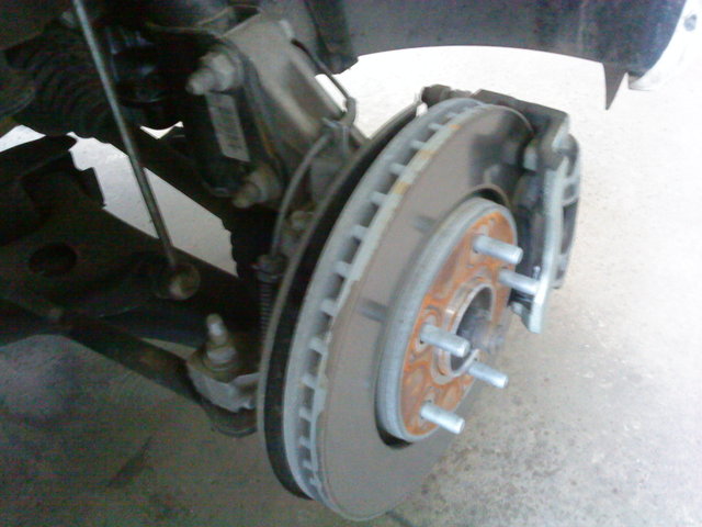

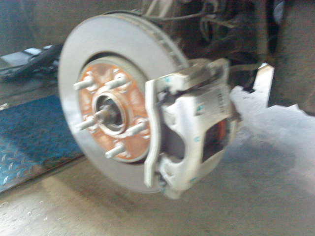

Default 2013 Dodge Grand Caravan with 16" wheels Front Brakes Pics
Attached Thumbnails 2013 Dodge Grand Caravan with 16" wheels Front Brakes Pics-fb2013gc3.jpg   2013 Dodge Grand Caravan with 16" wheels Front Brakes Pics-fb2013gc2.jpg

Thanks a bunch. Those are pretty clearly single piston calipers. Not the duals we see on the 17inch wheel vans. The gathering evidence is that the brake size is tied to the wheel size.
Interestingly I hear the same is true of the Saab 9-3 my wife drives. The cars with the upgraded (17 inch) wheels get bigger brakes.
Dave

2 ways usually you wount see space between the rim and caliper. pretty much big and tight in there. other option take tires off and inspect see if it has 2 push cylinders on the calipers.
I would still like to see who has one to get the part numbers off the clipers and brackets.
