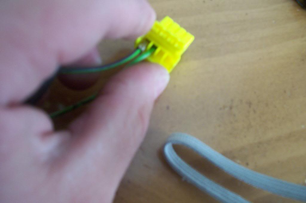

Decided to go ahead and replace the connector
Thanks to Tizzy1 for the source of the used connector.
I replaced the airbag connector today. Since my fix I had the airbag light come on/off only 4x, but hopefully this will be the permanent fix.
I practiced with the used connector, since I could sit down in good light and see just how it comes apart. I first was going to buy a tool set to remove connectors, but after seeing how I already had a super small flat head, I figured I would have a go at it.
First disconnect the battery…..
Well to remove the wires, first you open the back, I found it easiest to use my snap ring pliers to press the two sides apart and lift the back up.
Open of the wires a little to give you some working room, wires order purple, light green, purple, red (at least that’s the colors my eyes showed me, the first two wires and second two wires are tapped together, and then both groups of wires tapped all together.
Then you insert the small flat head under the terminal, with bottom of the screw driver angled up towards the terminal , letting it gently slide down the terminal about ¼ inch till it finds resistance, then you raise the bottom of the screw driver up towards the top, pressing the tip of the screw driver down onto the retaining tab.
Then you gently pull the wire out, should come out with little resistance,
