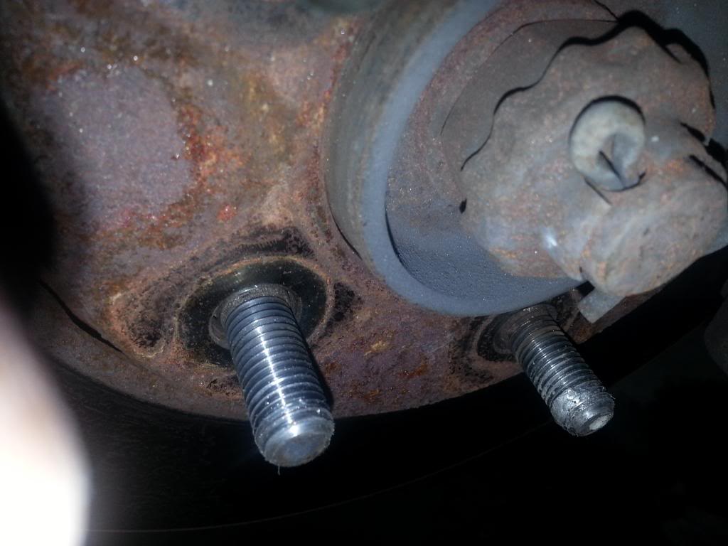

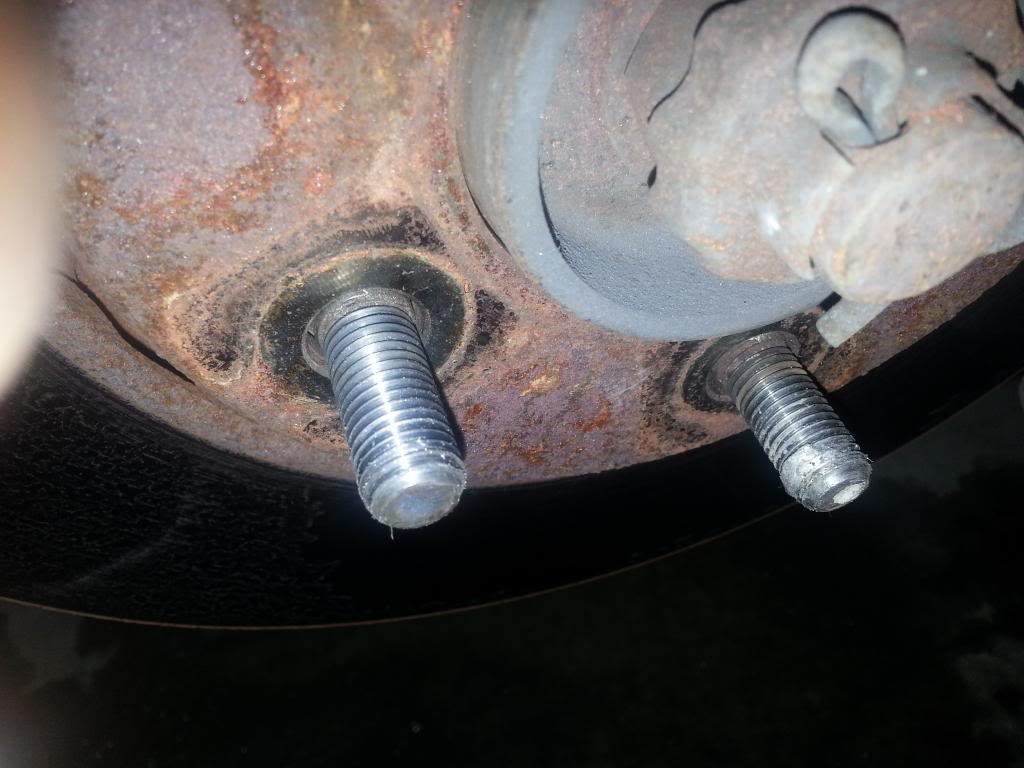

Question OUCH....Is this still ok??!
Before removing my passenger front tire i noticed it looked slightly off pointing to the right despite the steering wheel being leveled and the left driver side tire pointing straight.
When removing the right tire i noticed a couple nuts were tough to remove in particular the bottom one closest to the front of vehicle. Once all nuts were removed i notice the threading of the bolt didnt look so good....
You can see the one bolt's threads look all mangled. Can this be corrected?
I'm going to read up on WHEEL ALIGNMENT but in the meantime i will need to reinstall the tire but will at best only install the 4 nuts and leave the 5th off since it will NOT screw back on.
Old Dec 9, 2013 | 11:27 PM
Greatrack2012's Avatar
Greatrack2012
Joined: Aug 2013
Posts: 156
From: Peterborough, Ontario, Canada
To me it looks stripped. Since the lug wont go back on id say you need to replace it.
Old Dec 10, 2013 | 11:06 AM
Tizzy1's Avatar
Tizzy1
Joined: Jan 2010
Posts: 3,023
The one will have to be replaced for sure and a new nut. The one next to it doesn't look to good either but if the nut goes on ok, lube it a little anyway.
