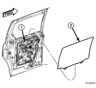

Well, you are more likely needed to replace the whole door if you wanted power window. The door frame is completely different. So if you are serious about it, you would need to find a used door from the junk yard first, and then figure out the wiring.
The cost and labor intensiveness is not worth the conversion, you better off trading your car in for another van that has it.

The attached pictures are what I was going on, believing that the glass may be the same. These pics are from my AllDataDIY.com account. One image is the fixed glass window installation/removal. The other is the power window option. You can see that the glass is shaped exactly the same, which really surprised me.
Not exactly hard evidence, but that is why I was seeking advice from others on this forum.
