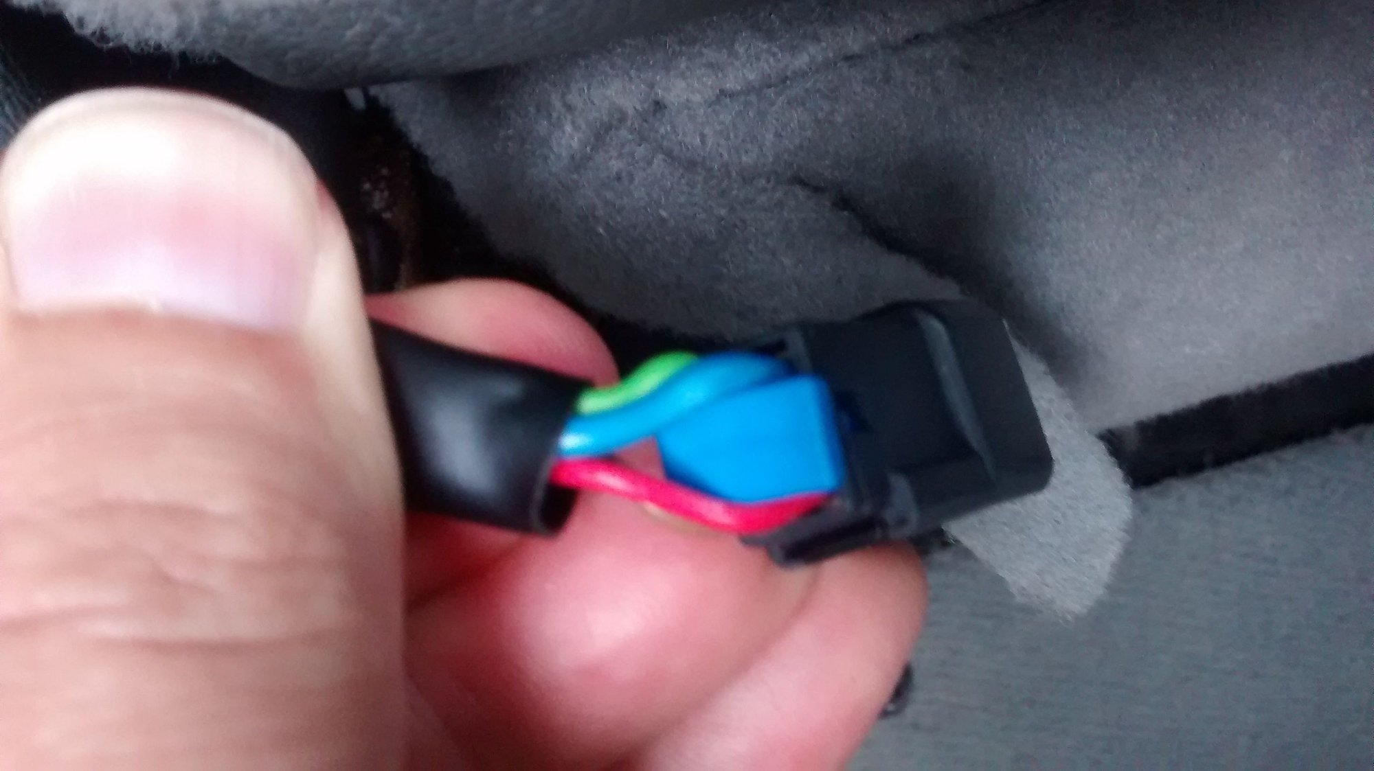

I figured it out on my own.
I disconnected the connector in the picture.
Used a jump-pack (portable car jump starter) connected to a pair of multimeter leads (so to have a smaller contact point).
-12vdc to the blue wire and +12vdc to the green wire.
It runs the seat back to upright position until wires are disconnected (or it will keep going and lay the back all the way ).
So seats are back in place and upright. I still have to yank those brackets and repair/replace them.
