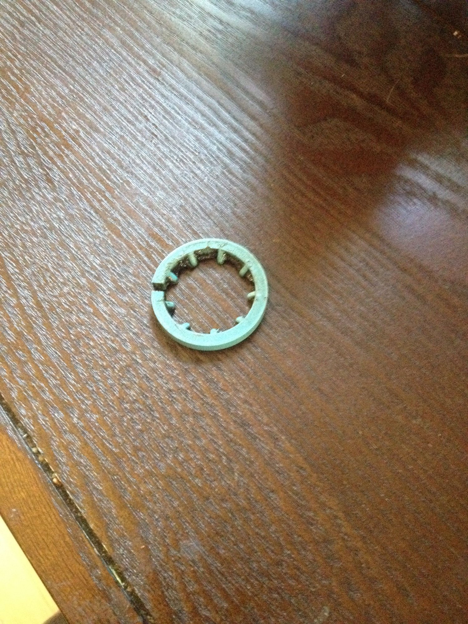

DO I need to replace this part????? Thanks for the help.

If anyone else does this repair; Chrysler sells the spacer with the OEM inner tie rods. If you buy after market, you will probably not get the spacer.
I have reused mine, not my first choice, as I would have rather replaced it with a new spacer. I have been unable to determine the risk associated with this choice.
