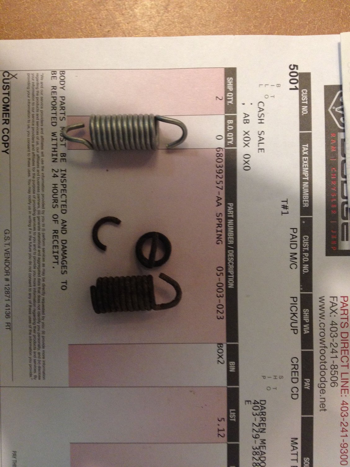

So had an interesting issue, smell from the rear passenger side brakes, I know these vans hate their brakes but found a nice busted parking brake spring - and I'm talking brittle, broke with any additional pressure, total POS, and funny thing had both ends even after breaking the spring. So long story short took off the wheel, inspected and here is a photos - cheap repair - Chrysler Part #68039257-AA
Part 12 on the link diagram
Rear Brake Diagram and Parts
$5.12 CDN per spring - Jan. 20, 2016

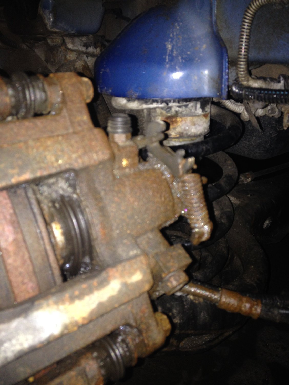

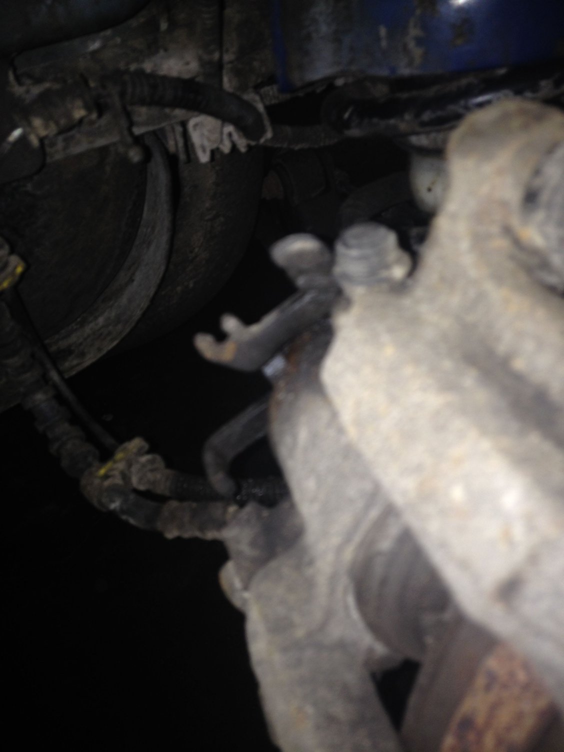

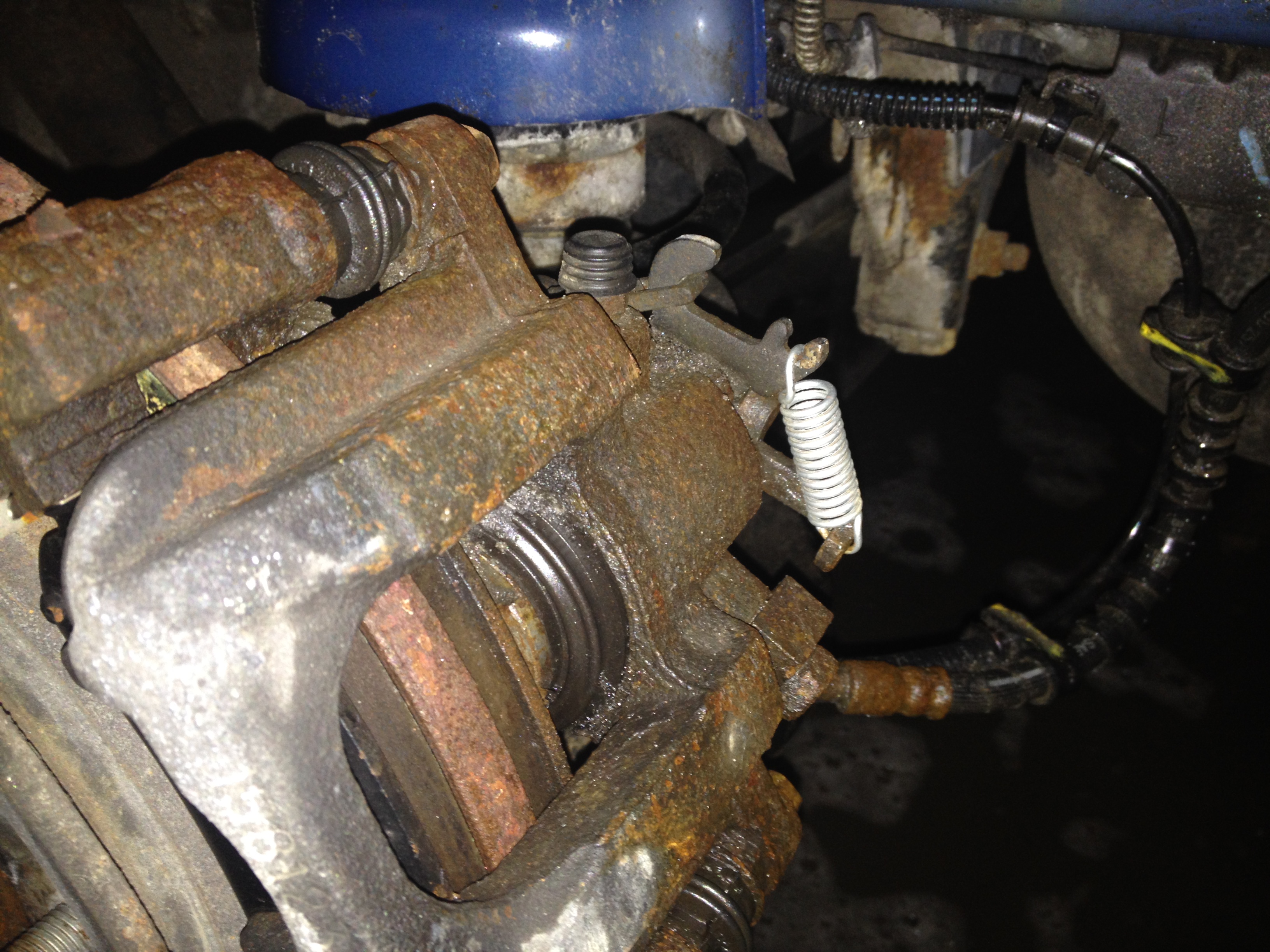

Additional Photos
dirty mess - thanks Canadian Winters
Springs missing
busted spring vs new spring
old spring that was not broken
