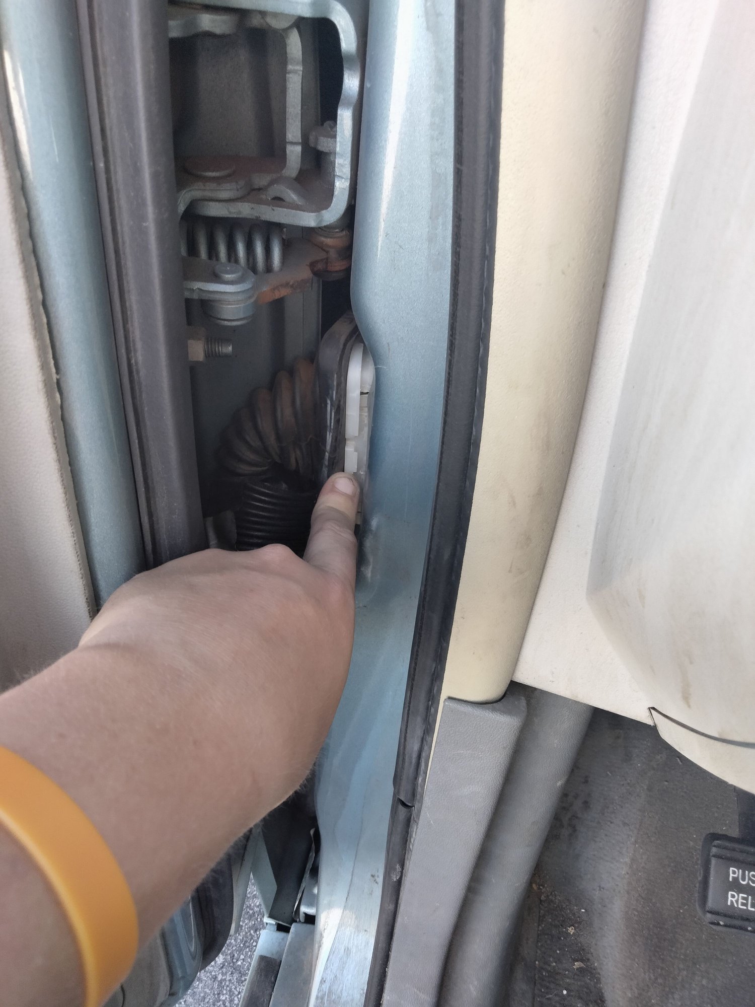

I didn’t look at when this was wrote but figured I’d comment for anyone who might look this up later on. You’re in the right place but the wire that’s causing your flashing and dinging is up just a little further on the other side of the rubber boot. Some of my wires were also broken up there. I also had almost all the wires broken when I opened up the boot and found the cluster I snipped and taped and got my speaker, windows, locks, door dinger, back to working but it didn’t fix the flashing or the dinging or the wiper blades. So I took the runner boot completely off and side rhr

Follow the wires up further the problem lies on the other side of the connector piece that you plug the door wire bundle into... I'm terrible at explaining. But I had the same issues and fixed all the wires in the door and it didn't fix the problem but I noticed when I was applying pressure while pushing the connector piece back into the slot the wipers and lights and sounds went off. So I unplugged what I had just plugged back in and what do you know?! The wires in the other side of the slot that you plug into were broken as well I hope I'm explaining that right.
Best bet is to remove your driver's door unplug the erie harness and set them aside. You won't have enough room to work on fixing the wires with that still on there.
Pull that out as much as you can and just wiggle them til you find which ones are causing the glitch.
