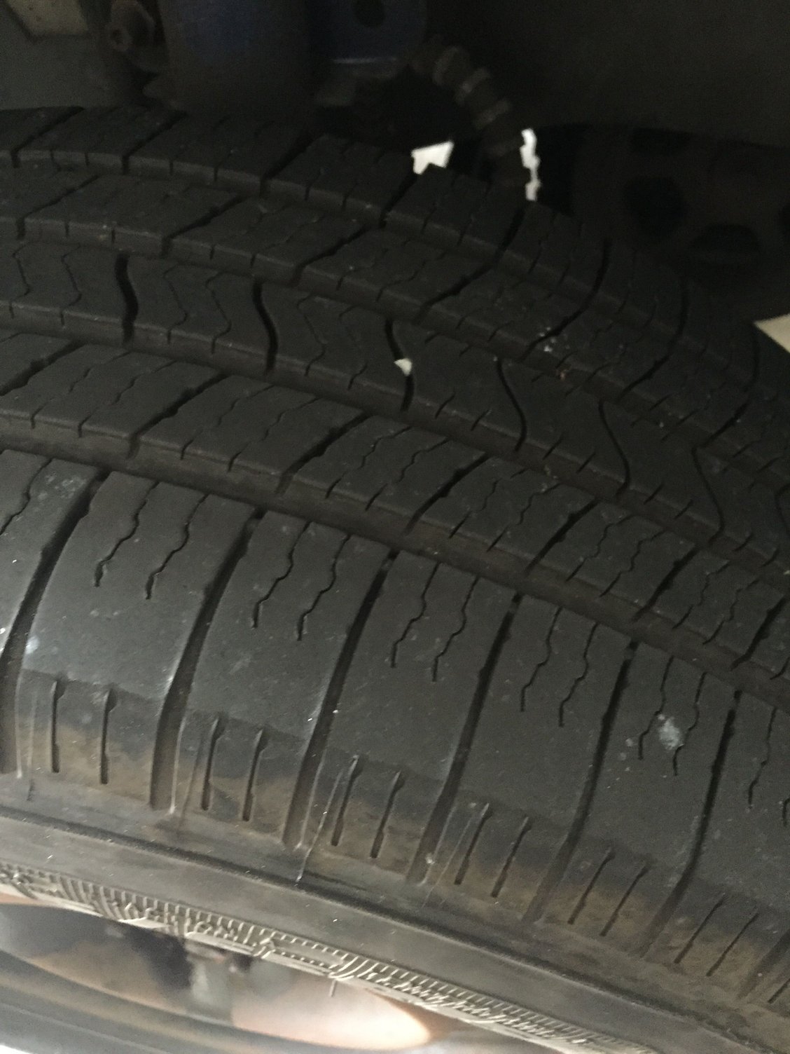

I have a 2000 Dodge caravan and recently my tires are wearing on the outside edge only on the front passenger side tire. All my other tires are wearing evenly besides that front passenger side one. I have recently changed the front struts and have already got an alignment done. The shop said there is something wrong but they don't know what is wrong. There is no play in the suspension parts. What can be the cause of the outer edge wearing rapidly only on the front passenger side? Did I miss anything or is there something I failed to check? Anyone else experiencing the same problem? I'll post pictures of the tire wear later.

Sounds like they didn't get your camber correct when they did your alignment. Or it wore that bad between installing the struts and getting the alignment. I'm gonna go on a limb and say the shop fail to do a proper alignment, and that's the cause of your tire wear.

Smooth even wear all around the outer edge would be too much positive camber. Either the adjustment is out of spec or parts are worn. If the wear is uneven or choppy it could be out of spec toe in adjustment or worn parts.

Contrary to popular belief, camber negative or positive, will not wear a tire, at least not quick enough to notice (unless you are one who accelerates or brakes heavily). Camber being off with the addition of toe being off will direct the wear to the inside or outside of the tire depending on positive or negative. A dead on alignment with negative camber, won't actually wear tires that much quicker.

I found the alignment sheet that did the alignment in May 2015. I drove the vehicle less than 2 miles to the alignment shop after doing the front struts. I feel like I probably do have a suspension problem but I don't know what is wrong. I don't want to be throwing parts on it trying to solve the problem. I bought my current Michelin defender XT set from costco at 218,000 Miles. My van now has 231,000 miles and the tread is at 50%. It is wearing evenly but it just wears a significant amount on the outside of the front, passenger side tire.
This is how the wear looks like. It only wears like that on the front passenger side.
This is how the alignment shop gave the vehicle back to me. They said it is normal and they adjusted it to the best of their ability. I only paid $60 for this alignment and they aren't a tire or alignment shop so maybe they didn't do a good job? Based on the print out, what is probably worn on my suspension and how can I check for it besides tugging on parts seeing if there is play. I've done that on my control arms, sway bars, ball joints and there aren't any play.
