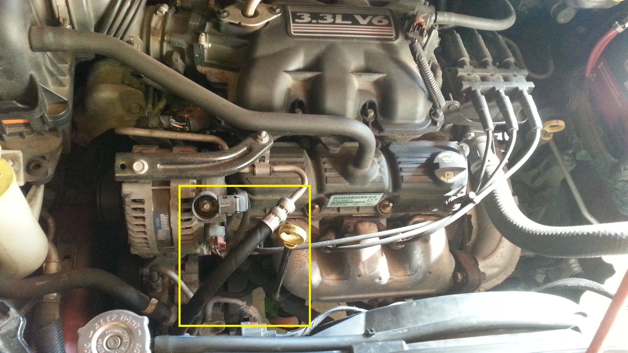

pic of leaking ac hose
This hose goes from the front of the vehicle over behind and runs under the vehicle before coming up on the driver side. Its very long, maybe 8 feet in total and has no connection along it that I see as being able to detach from the rest of the line. Consists of 3 rubber sections and 3 steel sections with no quick connects, only bolted at each end. Haven't been able to find a pic of hose online of that length that matches it. Not sure how to go about replacing this,

That is the power steering pressure hose, item #5 here: http://www.factorychryslerparts.com/...riveLine=11813
One of the A/C hoses is visible at the very bottom center of your yellow box. The bottom yellow line crosses over the nut that secures the hose to the A/C compressor, the second A/C hose connects to the compressor adjacent to the one in the picture.

Thanks for that info. I've looked at all the ac hoses but none appear to be leaking.Compressor turns by hand so not seized.Which 2 of the 3 pins on the pressure switch connector are the one's to jump to test if the compressor is working?
