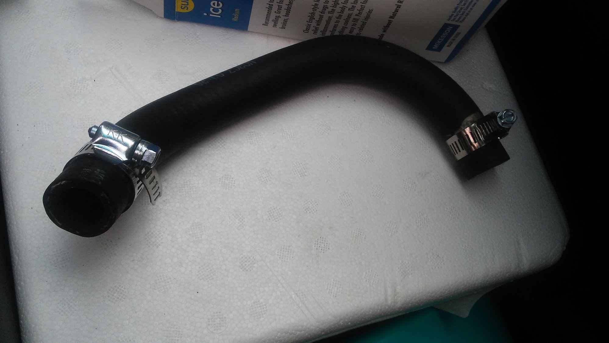

Where the piece broke off from.
I have a 1998 Caravan 3.3 flex and one of the hoses burst. We went to replace with a newly purchased hose and the piece you slide the hose on to broke off as it turns out it was old and rusted out, most likely the original part . I can't price replacing it as I have no idea what part to tell them I need and my local auto parts stores aren't very helpful. I'm a mom of 4 and one on the way and desperately need my can back on the road as our public transportation system here doesn't go outside of about a five mile or so radius and doesn't run very often so work days turn into 3 hours or more extra and appointments get missed and groceries get hot etc. Please can someone help me out with what this piece is and any other info you may have would be helpful. Thank you!
Piece that broke off.
Another angle of the piece that broke off.
The new hose waiting to be put on.

I can't tell for certain, but I believe that is the water pump nipple, Mopar part number 04621652.
https://www.factorychryslerparts.com...driveLine=7287
