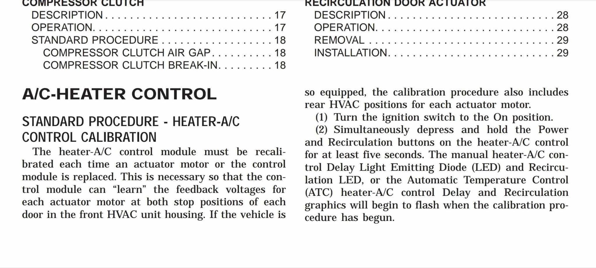

Old Dec 29, 2024 | 05:54 PM
Zeyamorrison666555?'s Avatar
Zeyamorrison666555?
Joined: Dec 2024
Default Blend door calibration procedure
Originally Posted by *****.18
Hello All,
Installed new rear blend door and my 2012 GC likes to blink the rear defrost on start-up & various other times to calibrate the blend door actuator, so I've read on-line. My question is, why does it do this over and over again. Is it because I am a dummy and haven't taken it to a qualified person with the right piece of tech/software to program the actuator? Does this van need to go to the dealer, or is there something that I can do?
Thank you.
