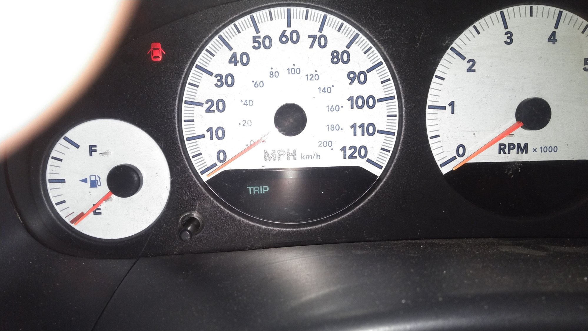

I have a problem with the odometer on my 2005 Dodge Grand Caravan SXT. The problem is that there is no mileage display for my odometer. This is to say it appears that all of the segments of the display seem to be functioning properly and the rest of the instrument panel seems to be ok as well. But the mileage display is blank. If the odometer display is changed from normal to trip the only thing that is displayed is the decimal point for tenths of a mile and still no numbers. If I go through the panel reset, all of the segments for the display light in sequence and all of the instruments go through their calibrations and the panel goes back to a normal state but no mileage display. I don’t know if this matters but the overhead display does light however that odometer doesn’t increment up it just stays at 0.

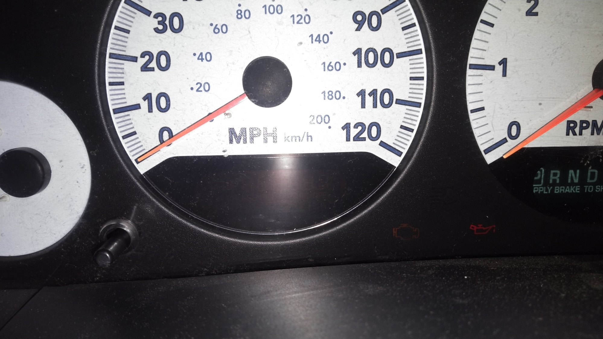

Odometer under normal conditions
Odometer with Trac Control Off

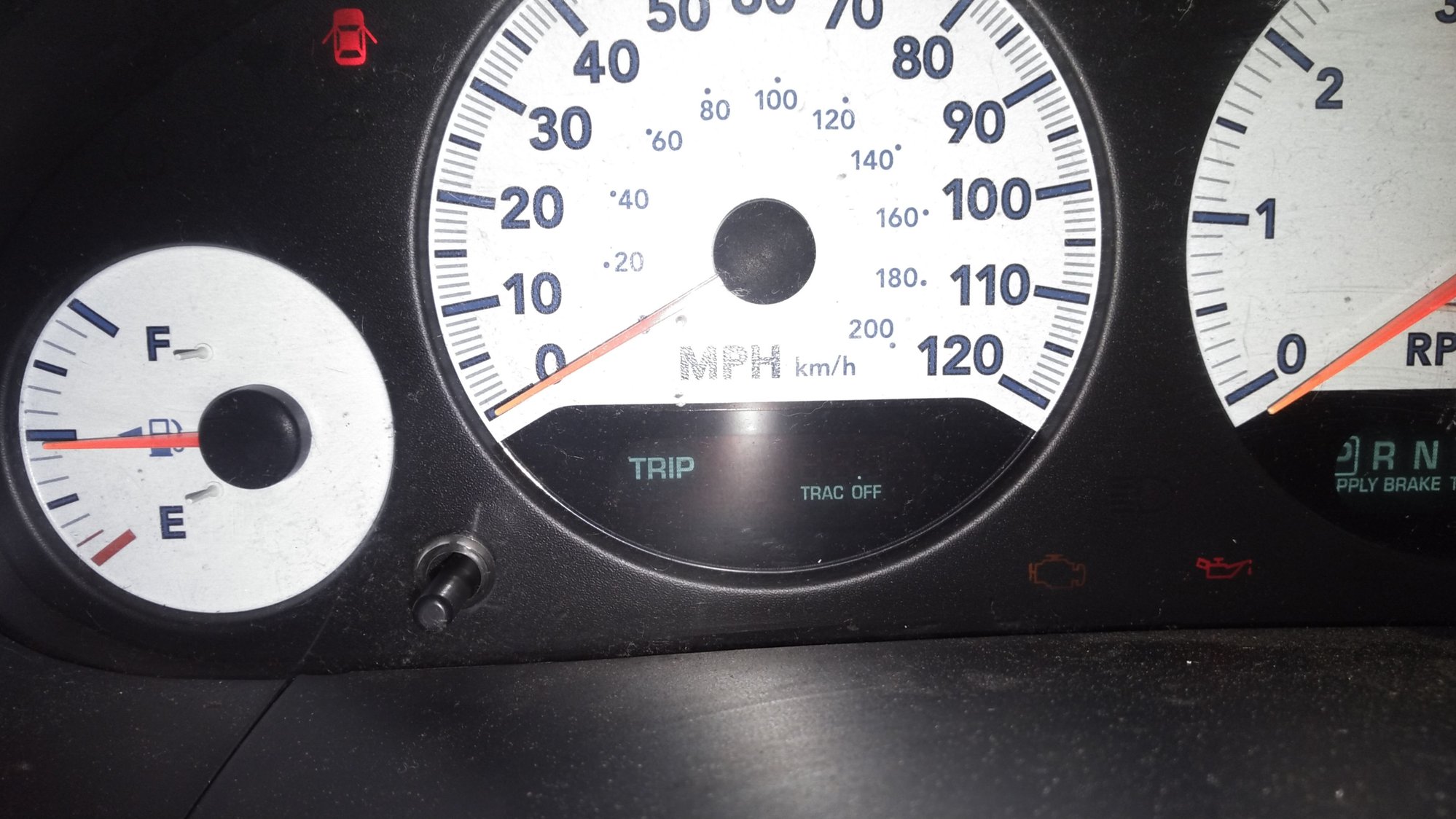

Trip Odometer under normal conditions. ( Note Decimal for tenths
Trip Odometer with Trac Control off( Note Decimal for tenths

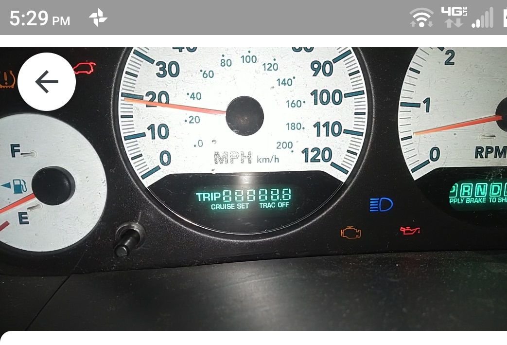

Odometer under dash calibration / Test mode. ( Note, all odometer segments Light)

It’s probably an internal issue with the cluster. The protocol it uses to perform the self test is different than what it uses to command the odometer to display mileage.
All the info the cluster receives is through data feeds - mileage is going to come from the PCM, but there won’t be a dedicated circuit for it - it’ll be on the bus circuit as the TCM, BCM, anti-theft and other modules need mileage data as well.
What you need is a scan tool capable of reading live data that the instrument cluster is receiving. If live data shows a mileage reading, the cluster has an issue. You can have it replaced or repaired - you’ll just have to google businesses in your area that are capable of doing the repair and you should expect it’s going to take at least 2 days.
