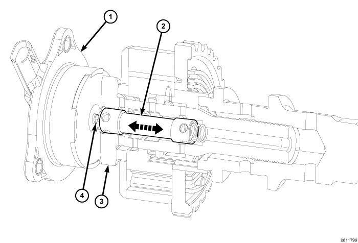

The image below is a cutaway of the cam and actuator set up. Item #2 & #3 is an assembly that you need to remove.
The code references the intake cam shaft on the front bank.
If you look just above the right side of the spool valve (#2) you can see the casing of the actuator/timing gear is fitted around the end of the camshaft (I don't know anything about editing images otherwise I'd of highlighted it for you). There are also alignment pins/keys between the cam and actuator (not in the drawing) - removing the oil control valve alone will not cause the actuator to just fall off the cam or allow the mechanical alignment of the actuator and camshaft to shift.
There's really not a great deal of tension on the chain when the engine isn't running, so practically speaking there's little reason to be concerned that the actuator/gear assembly will fall off the cam with the oil control valve removed.
That said, I did some digging and I think it would be beneficial for you to remove the valve cover. Once it is removed, you can take the tension off the camshaft and remove the oil control valve. There's no need to remove the chain or mess with the tensioners - the camshafts are designed with a hex molded into the end of the shaft near the actuator specifically for using a wrench to rotate them. All you need to do is rotate the camshaft slightly in one direction or the other (typically counter-clockwise) until you see the tension on the chain release (it will appear to go limp).
This will take the tension off the actuator/gear assembly and allow the oil control valve to be removed without worry of it coming off. I recommend breaking the oil control valve loose before relieving the tension. You may also have to rig up a way to hold the camshaft in place while you're cleaning the oil control valve. It depends on the position of the lobes - sometimes the cam will hold its position on its own, and sometimes the valve springs are pushing against the lobes.
1= Solenoid 2= Spool Valve 3= Oil Control Valve 4= Solenoid Pintle
