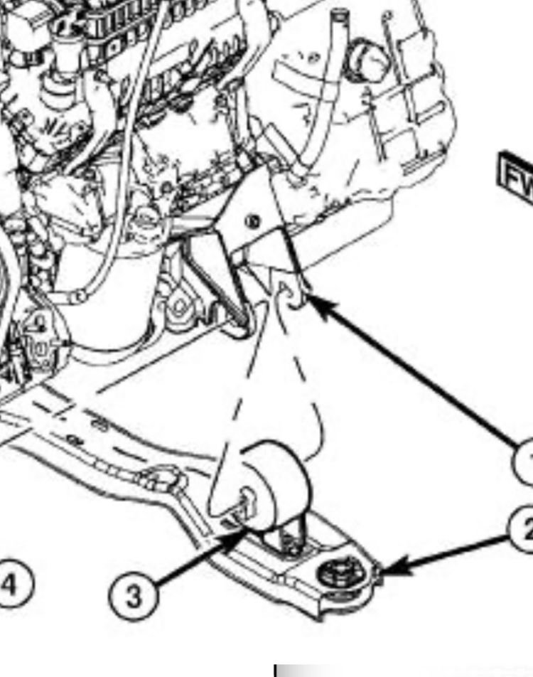

This is the front motor mount (#3) - you only need to remove the through bolt.

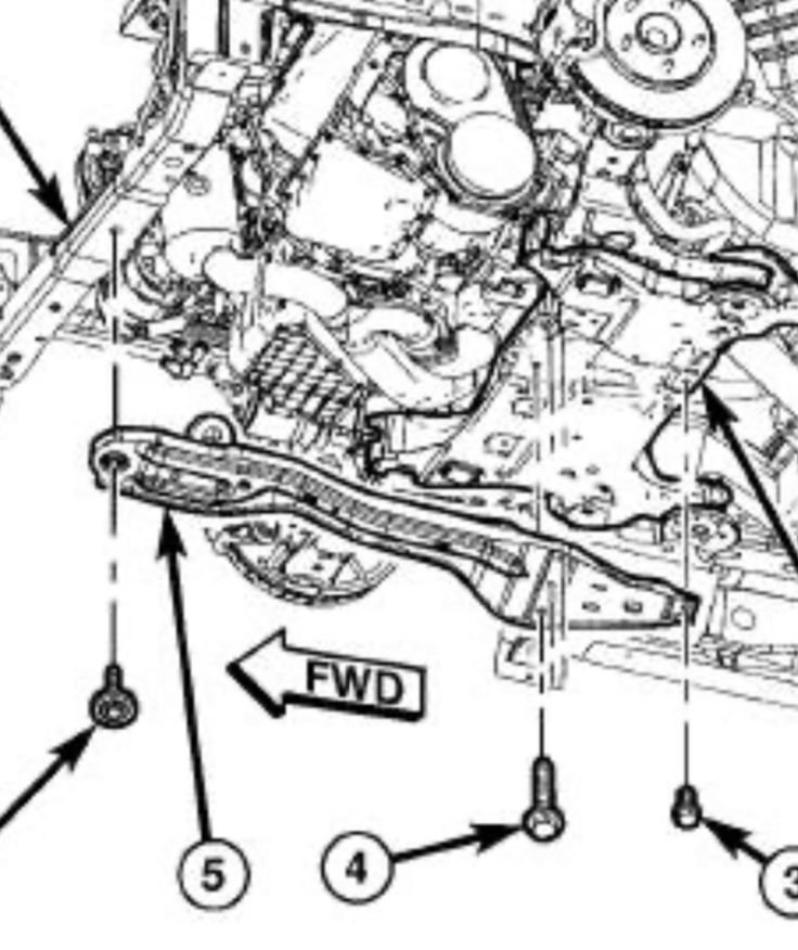

This is the fore-aft crossmember - it’s what the front motor mount attaches to.

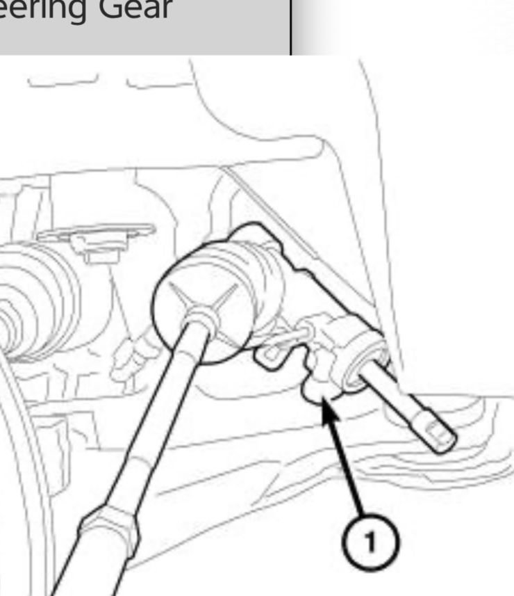

This is how the rack needs to rotate to be removed/installed from the driver side.
