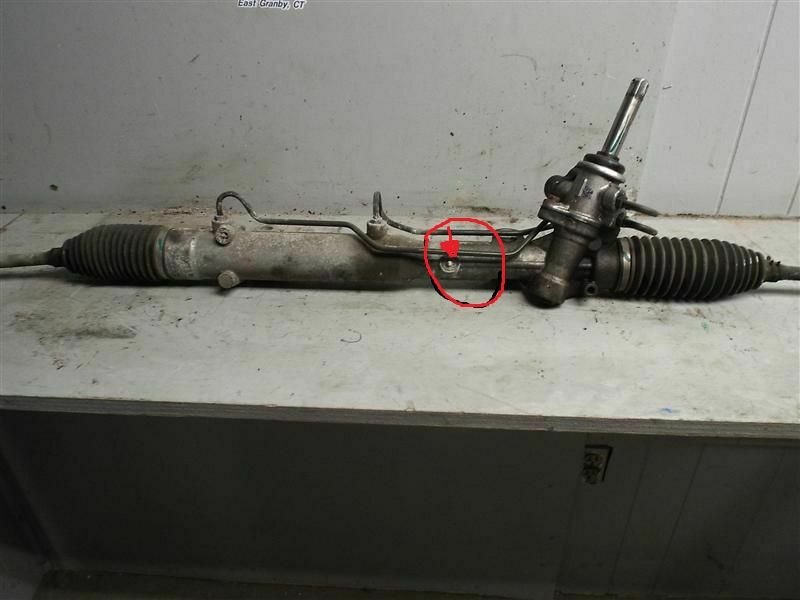

I've got a pinhole in my Rack & Pinion. Probably need replacement?
It's not at any hose connections, but right in the damn middle where I can't get at it to see (Motor side)
Anyone have a step by step for removal and replacing, or anywhere that I could get a step by step info?
I really can't afford a Mechanics price of an all day job, but can afford the Steering Rack it self, plus an alinement afterwards.
Anyone know what this part of the Rack & Pinion is?? See Attachment:
This is where the steering fluid is spraying out from.
I've googled a 2012 rack & pinion image.
That is the spot where fluid is spraying from. Is it a plug of some sort?
Could it be fixed with a new plug maybe?

Appently and I'll assume that nobody has ever worked on a Rack & Pinion before?
All I wanted to know, is what is that spot I've circled on the diagram is? Is it a drain of something like that and maybe just need a new O-ring?

For my part, I do apologize for not responding - I remember reading your post and meant to do some digging for you, but then life happened and it slipped my mind.
It’s hard to know exactly what’s under that plug. Most shops anymore don’t repair them because the parts can be difficult to source and in most cases, the cost in labor to repair can be close to, if not more than, just replacing the rack. That’s for a shop, mind you, not for someone doing it in their garage/driveway.
It’s hard to see in the pic but is that plug retained by a snap ring or is it threaded? If a snap ring, there’s most likely a spring under it. If threaded, there may or may not be one. If you can find an ID tag, it’s possible a parts diagram or exploded view can be found to get a better idea. Unless you know for sure the rack hasn’t been replaced before, I don’t want to assume it’s a mopar.

The original rack, bought the Van right off the lot and had it ever since.
It's so dang hard to get in there, reach around that motor mount, and feel that spot.
Can't even tell if it's a nipple or screw or whatever...

After reading back through the thread, I have a couple of other ideas/suggestions-
1) Are you certain it’s the plug and not the line right above it? The lines are easier to source in most cases. Even if it is the plug, it may just be an o-ring, but you’d still have to remove the rack to repair it.
2) You said you’re willing to replace the rack if you have the procedure - the process isn’t that complicated but will require a tie rod separator if you intend to repair and reinstall the rack. I can give you the steps if you’re still interested.

Thanks for the reply once again GumbyRT.
No it is not the line, sure wish it was.
But it is a fine spray coming from that on spot circled on diagram I posted.
It would be wonderful if it is a O-ring. This way I wouldn't have to get the whole Rack replaced.
