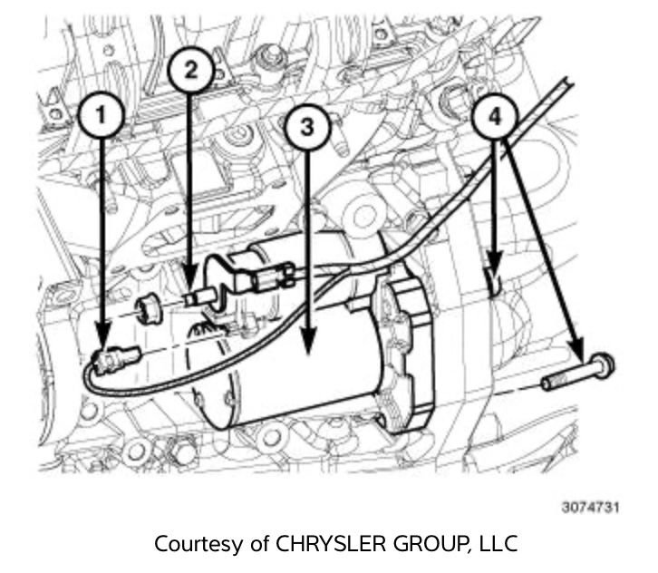

Could someone please list any tools that may be particularly handy, or required to perform a starter replacement on a 2012 GC SXT 3.6L outside of a general set of 3/8" drive sockets & some wrenches. I saw that the manual says to take off the front cat & go at it from the front, but I think I may go in from underneath laying on my back. If someone can mention nut/bolt sizes, you'll save me multiple trips from under the vehicle. I'd take them all, but the dolly has a hard time rolling over a pile of scattered tools.
Any tips on tools, or technique would be appreciated.
PS, Any advice on what brand of reman, or just go with a new unit?

If you can get the starter out without removing the cat, then certainly do it. However it’s always best to be prepared so I’d recommend having gaskets and replacement bolts ready for the cat just in case - you can always return the parts if you don’t need them. It was hard to tell from the diagrams I was looking at (and I’m yet to replace a starter on a 3.6) but it appeared the starter is positioned in a place where there’s not enough clearance between the cat and engine to remove it. Additionally it looks like the front mount and bracket need to be removed to access the starter mount bolts.

As to bolt sizes, everything from the factory is metric (if you have SAE bolts on it, a PO is to blame). I’m not swearing any of this is true for your van, but some common sizes are:
Starter bolts - 15
Exhaust/Cat - 13, 15
Engine mount - 15, 17, 18
Other common sizes - 8, 10
Good luck.
#4 are starter mount bolts
