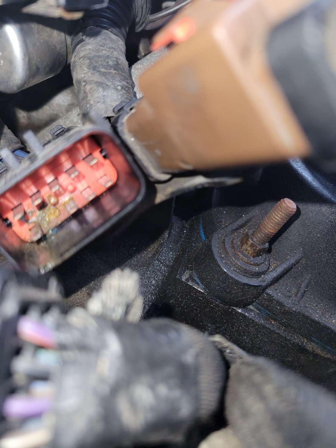

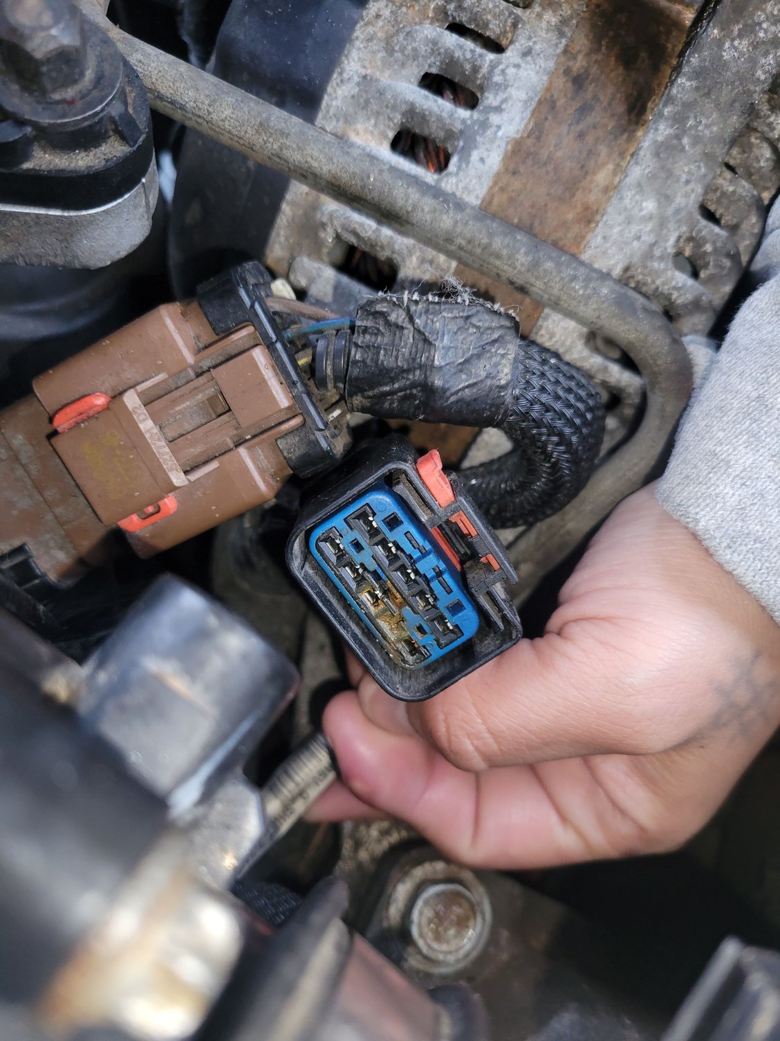

Try also checking the 2 large connectors near the throttle body for corrosion. These connectors are known to have problems with water intrusion and causing problems.
what r these 2 connectors connected to? one of mine right below the throttle body has corrosion on them

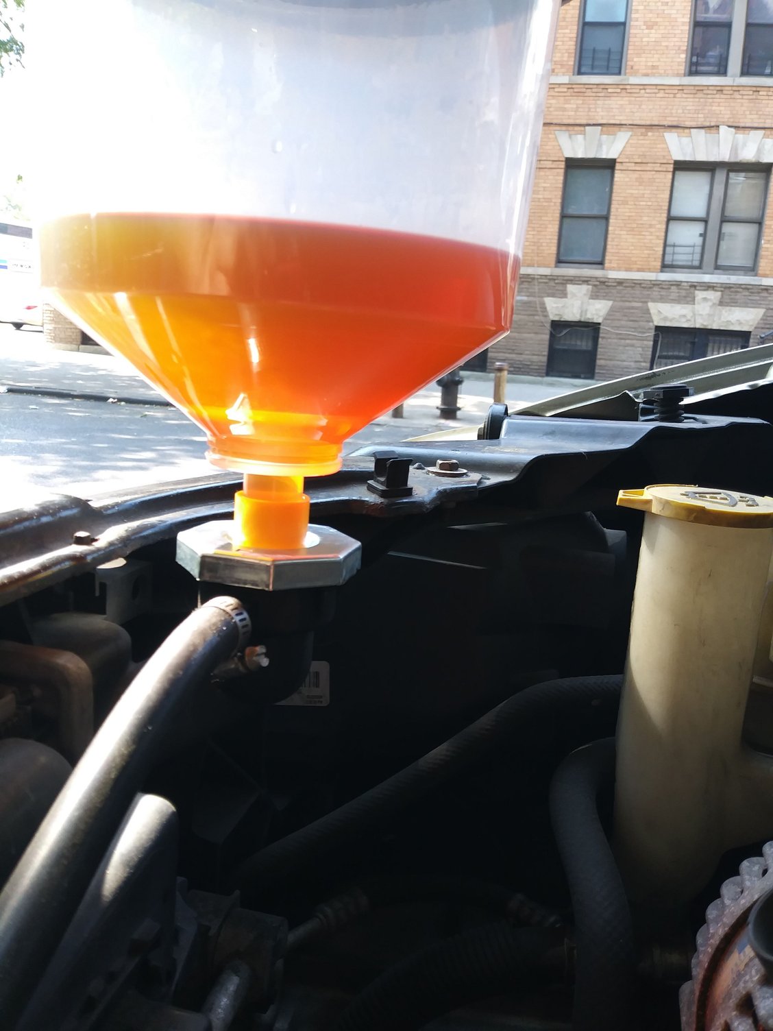

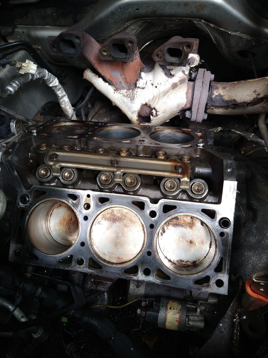

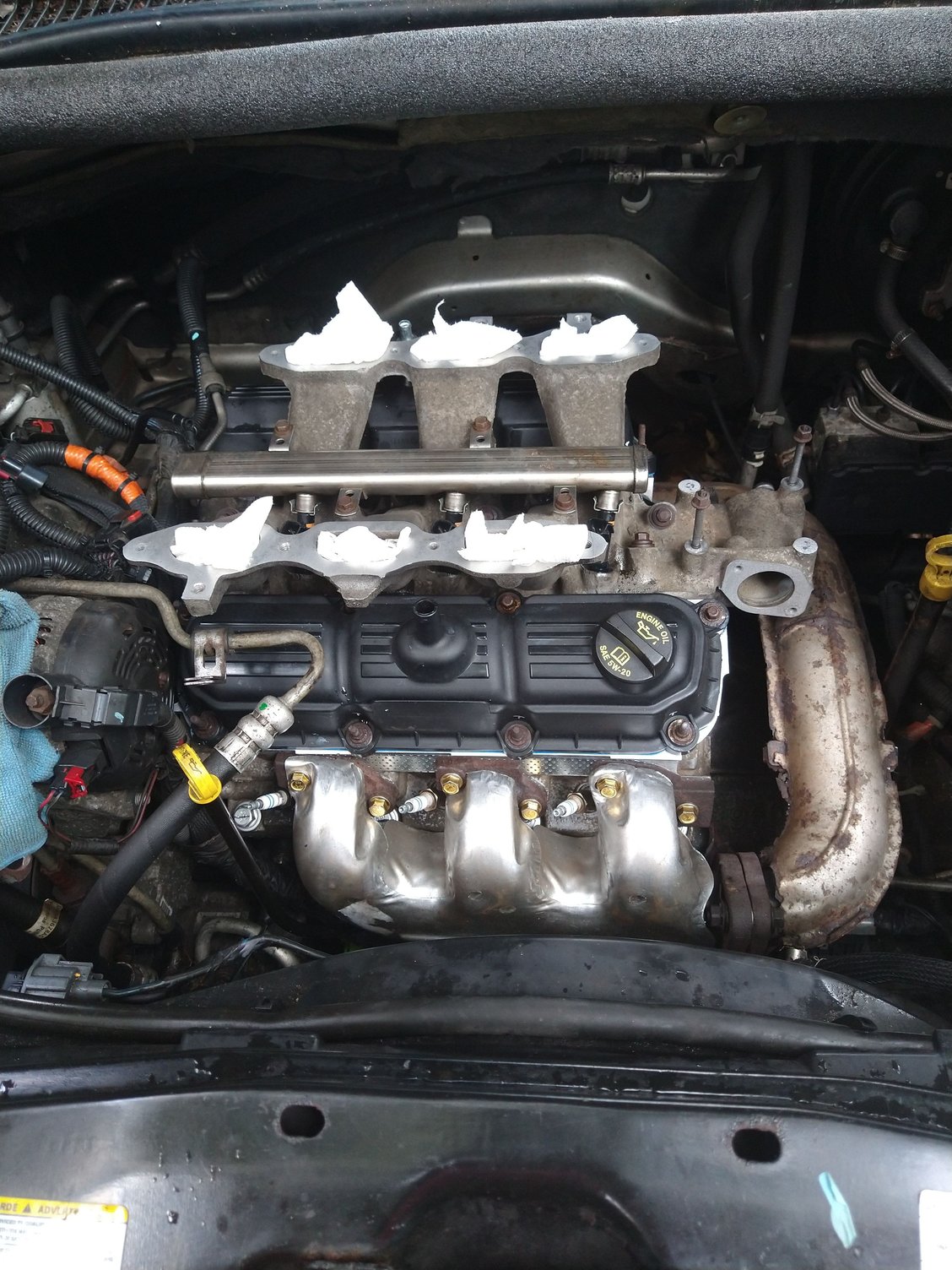

......Already got it fixed , thank god . That was the first thing I checked - most often advice you see online are those 2 big connectors because all the injector cables and sensors go trough there ....but everything was pristine - like from the factory ...... as you can see probably in the previous posts i did check the cables for short to ground and positive checked for continuity and resistance , from the injector plug to the ECU PCM coresponding pin .......checked the inectors resistance - it was whithn specs ..... even checked compression on all 6 cylinders .....it was all about the same....+/- 20 psi difference ......even with different ECM/PCM - what i call "car computers" - . i was getting misfire on cylinder 3 lots of times and then usualy misfire on all 6 cylinders ....i think the problem on cylinder 3 was causing the circuits in the computer to burn ....but thats ust my crazy theory - could be wrong...... eventually i started getting high pressure in the cooling system and the coolant turning orange instead of the regular light yellow green (Presotne) - i self diagnosed a blown head gasket .....oil mixing with coolant .....again - not an expert
.......got tired of going to repair shops and paying crazy money for no good results ....finally fixed it myself......unbelievable - what started in 2020 ....got fixed in 2023 ... -)
..........disassembled the top of the engine and the engine heads - bought a full gasket set on ebay for 60-70$ ......cleaned the old gaskets stuck to the aluminum .....sanded and polished the block and the heads myself ......bought a set of sandpapers from Amzon from 120 grit to 320 - 400 - 600- 800 - 1000 grit .....polished everthing like a mirror .....my intake valves looked clean but the exhaust valves were covered in carbon ....again ...got a full set of intake and exhaust valves - all 12 for like 80$ on ebay .....roto-polishing machine on amazon or 30$ and cleaned and polished all the ports on the heads - cleaned all the carbon build up - and it was a LOT ..... - got "lapping" compound from Autozone -8$? - seated all the new valves in the heads ......and assemled everyhing back .......since it was already open and accesible cheanged the crancshaft and camshat sensors - they are less than 20$ each .....pain in the *** to change with engine in regular operating condition - so why not do it when its easier and everything is open .....changed the inectors again - got a good set rom Amazon - chinese inectors or 60$ set o 6 ......checked again the cables running to the computer - for gazzzilionth time - all fine .....changed the water pump - because high pressure in the system damaged it .........and.....what do you know ......started and has benn working perfectly ever since for the last year ....spring 2023 ...till now ...writing in Feb 2024 ....
......i guess the moral of the story would be.....if you want it done done right - do it yourself ......
....I don't know if I ust had bad luck with repair shops that didnt have enough experience ....or is it ust how they operate - just trying to put a "band aid" on a problem - get the money - and send the customer away .....nut none of the 3 shops i went over time detected and ofered to fix the issue correctly ......None of them detected compression problem .....first one charged me even they said "We have no idea why it's misiring" ....but we charge for the time .......second one lied to me that they fixed a pin in the harness - which later i opened and it was factroy sealed - and it's clear nobody had opened it to do any work on it ......third shop even worse .....just changed the computer (that kept burning) from constant misifres,,,or just shops putting junk computers ....

......thats what blown head gasket does to yellow/green Prestone Coolant .....turns burned orange .....::-)
