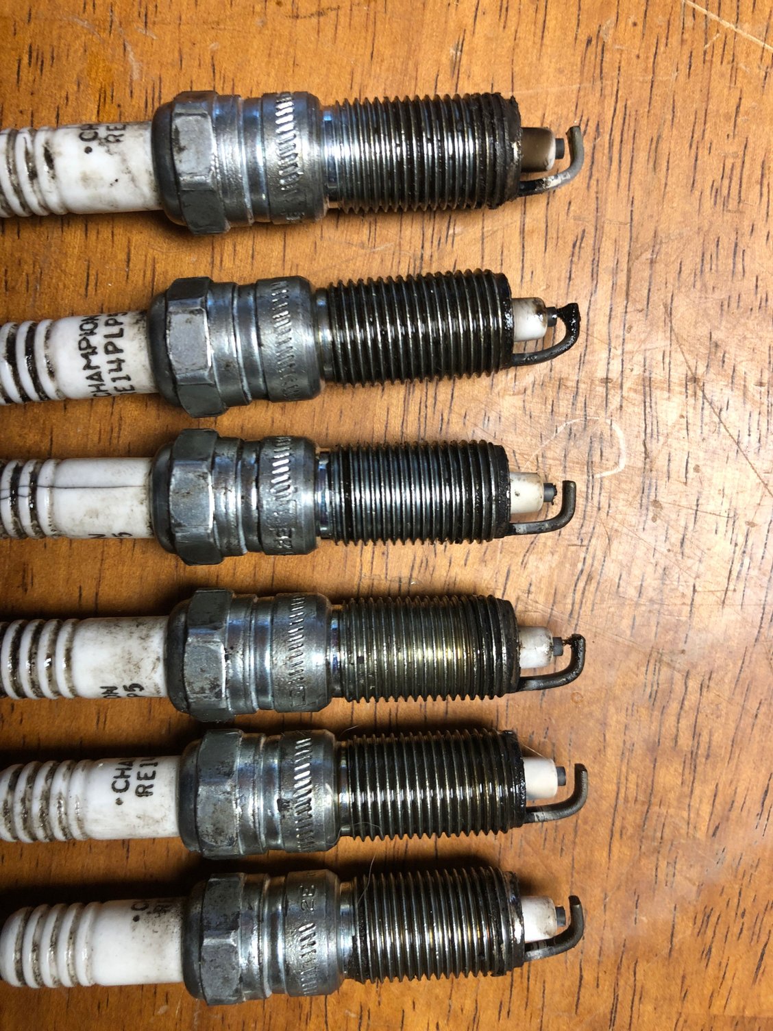

Any ideas what I should do next to solve this misfire? I replaced the spark plugs. The wires look brand new. I have not inspected the ignition coil pack as I'm not sure how to do that yet. I have a feeling someone was attempting to fix this at one point. Several busted electrical connectors (although most zip tied together), and the cam shaft sensor not seated properly make me think whatever was attemped was not done properly. Anyone have an FSM for this motor?
