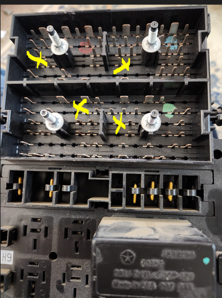

this has happened twice where the signal lights and blower motor and wipers stop working then I leave it or restart it and they work ???
any ideas? relay ?
For Example last night when it was raining (Dec 7 and rain in SK.CA WTH???) the blower and signals would not work , this am Dec 8th -6C and dry they worked?
1 other detail I put in a new BCM last summer from flagship 1 so it could be that I didnt tighten down the connector bolts properly for the 4 fuse panel connections
Ill check this weekend Dec 9-10
I am wondering if one of these blocks RED BLUE BLACK or GREEN have all of those curcuits in them? I reseated them all and havent had an issue for 3 days?
let me know if you have any idea what else to look at
