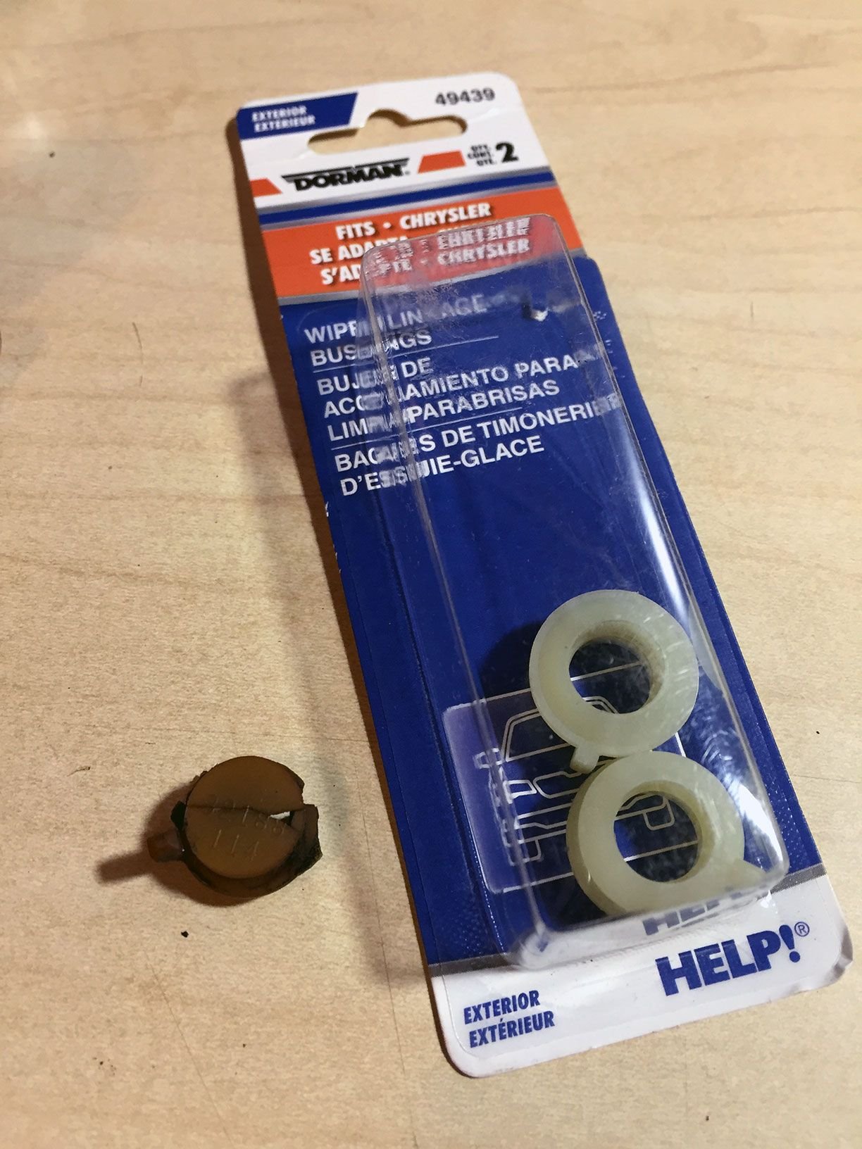

I have a 94 Caravan that the wipers stopped working on in the rain recently. I could still hear the motor so I assumed it was the bushing that failed. All of the parts websites says that this vehicle takes Dorman 49439 so I picked that up but when I opened it up I found the original split in 2. I can clearly see that it is different and the Dorman part will not work so I need to find out what will but I'm not having much luck. There are 2 numbers stamped on the part that are 32188 & 114. I have attached a pic. Hopefully someone can point me in the right direction. Thanks!

To answer my own question it looks like Dorman 49440 is the closest match I can find even though it is not listed for my vehicle.
