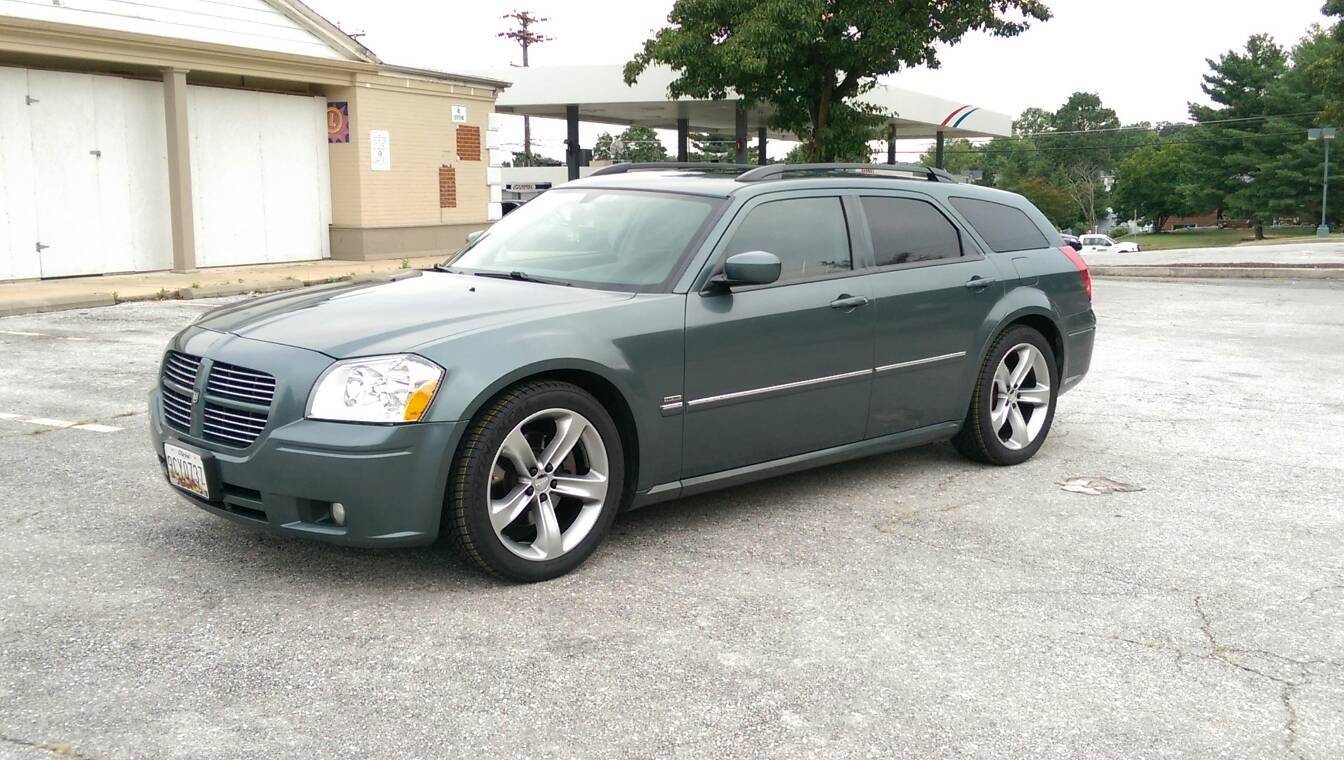

Factory 20x8 snowflakes. Stock size is 245/45R20. Widest you wanna go is 255, this is a 255/45R20 on an OEM 20x8 on my wagon.
If you upsize to a 20x9, 275/40R20's are perfect. 20x9.5 (narrow body) and 20x11 (wide body) are the only factory options from there, otherwise you're looking at aftermarket rims.
