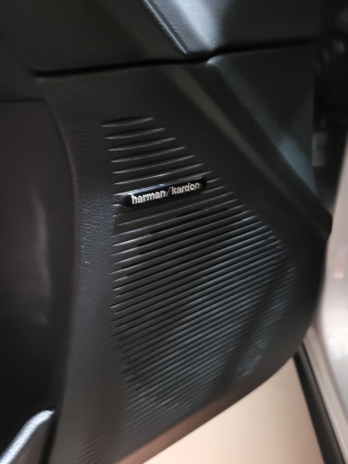

Right from the factory, line item on the window sticker, pic of driver side door. I didn't notice anything in the trunk. Shoot, now you've got me wanting to try it out!! :-)
