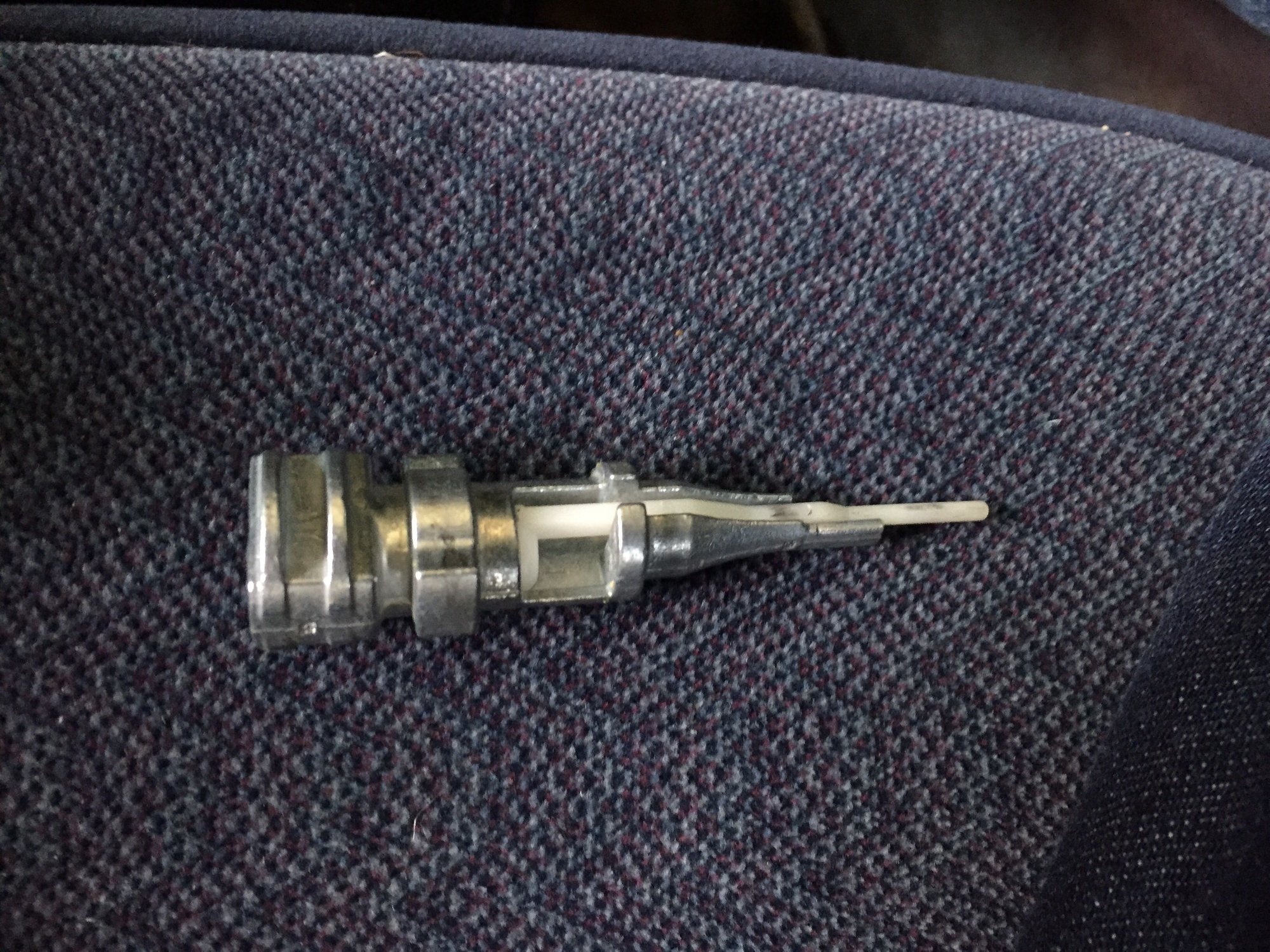

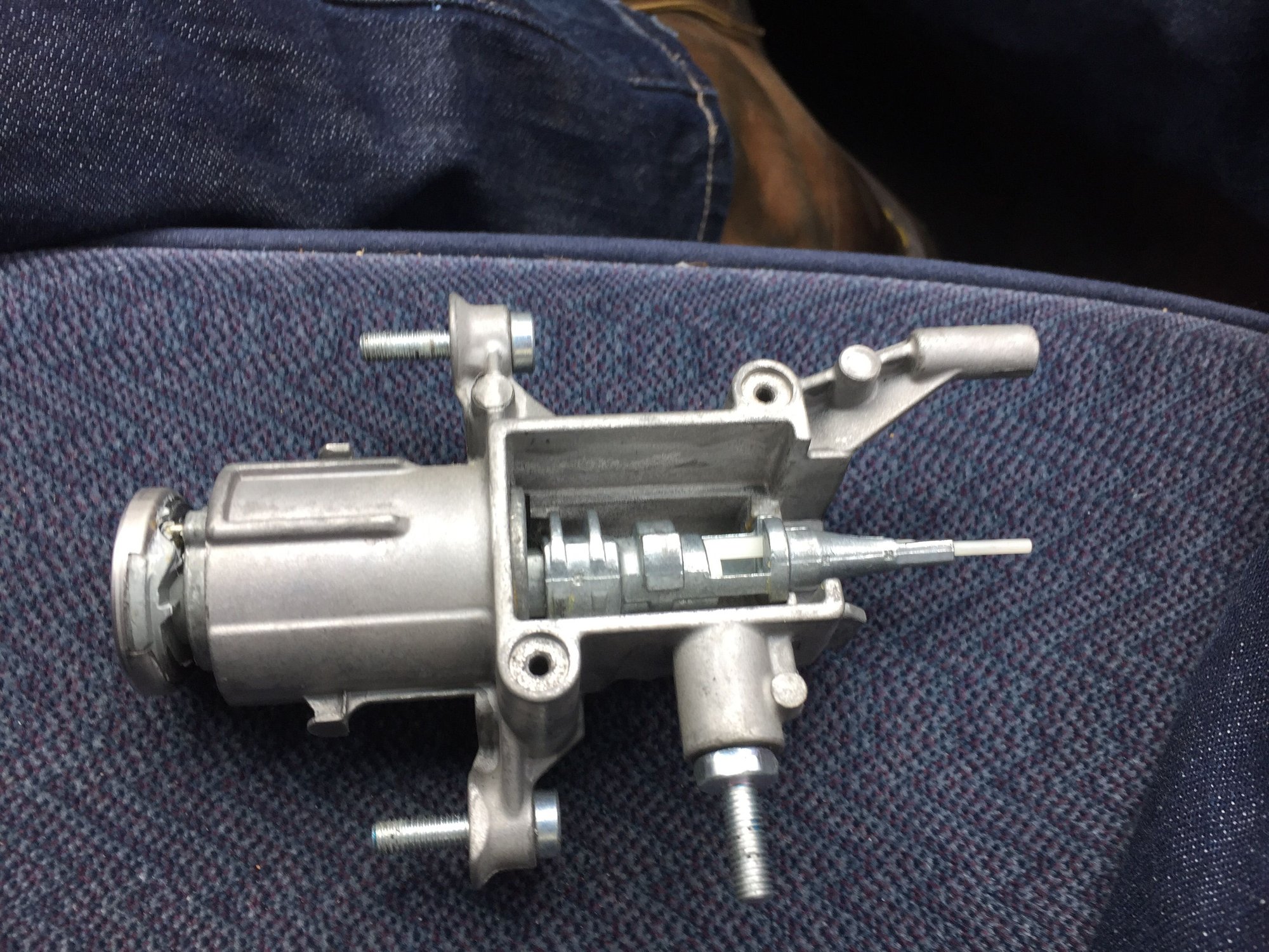

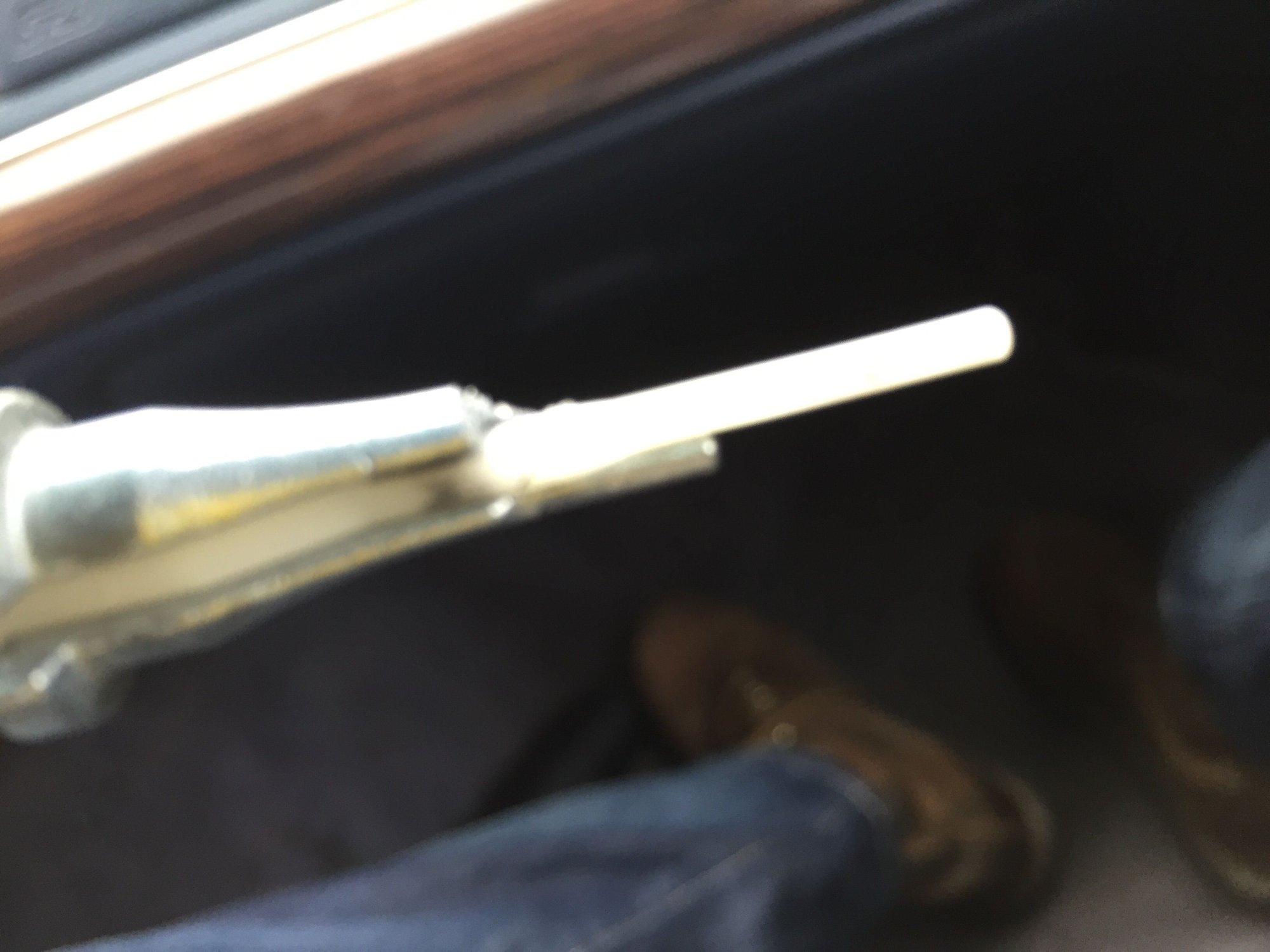

Okay, so, it was not bad connections or cables. For anyone in the future that may have this issue it was my ignition switch's actuator pin that had broken off. That was it.
Can see the piece that has broken off in the picture. Alright, thank you.
You can see the piece that has broken off.
