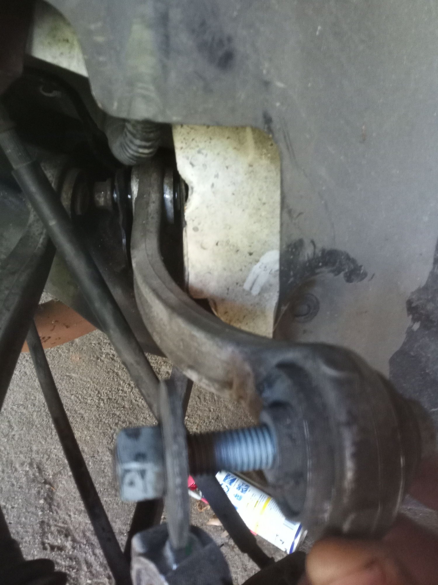

I cant figure out a way to take off my rear upper forward control arm. Does anyone have any way they have been able to get it off? If so I would much appreciate the help. Thanks in advance

Gotta be a way to pull that bolt. Probably from inside the trunk somewhere.

Already too the back seats out and completely clear the trunk and can't find anything. It seams like it's behind the back seat but I can't seam to find anything to take off or a type of trap door to get to it.

See if you can find a factory service manual for your car. That should actually have a pic of how it goes together, and simply tell you how to get that bolt out.

You have to drop the cradle, at least on that side far enough to clear.
