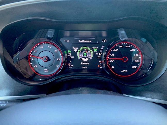

Default Check engine light from new member!
Hello! decided to go all American starting this year; so when my Audi A4 lease came due, I decided to get a 2019 Dodge Charger Daytona 392. I love the car.
I've been doing some minor mods just to get my feet wet and I changed the coolant thermostat to a 185 Mishimoto as recommended in some of the forums. It's been fine for the last 200 miles or so. Yesterday, I got a check engine light with the code P0128; apparently a thermostat error. I had gone out in a hurry and, of course, accelerated rather quickly to start my errand trip.
How can I remove this light? Any help would be greatly appreciated.
Save me a trip to the dealership...
Thanks!
