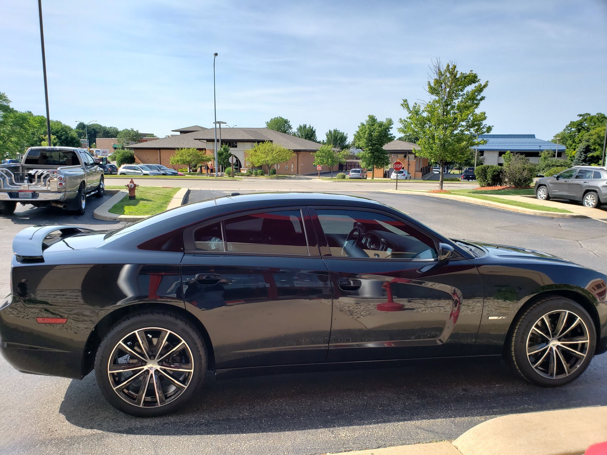

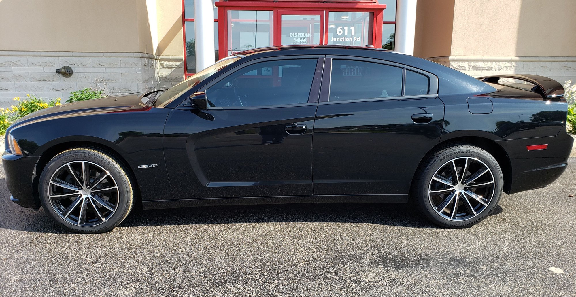

I replaced all rotors (drilled/slotted), pads, calipers, bled brakes replaced brake hoses. I also took the tires back and upgraded from the factory 19's to new 20's with General G Max tires. Got the new wheels and tires before the brakes. Didn't change the problem at all. Did all the brake work, took for a test drive (car was cold) and it seemed the shimmy/wobble was gone. Until the ride home. I got a few miles from home and noticed a slight shimmy at about 55 mph. It was very subtle so I tried to ignore it. Next day, verified that the problem is still there driving and braking under same speeds as before. It was less severe but definitely still there.
