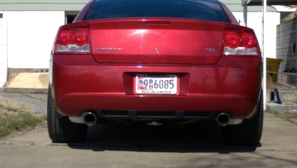

Taillights for both 06-08 and 09-10 Chargers (pic below I had converted to the newer ones)
Rear valence for an R/T Charger
Magnaflow catback exhaust for an R/T (valence & exhaust are visible below)

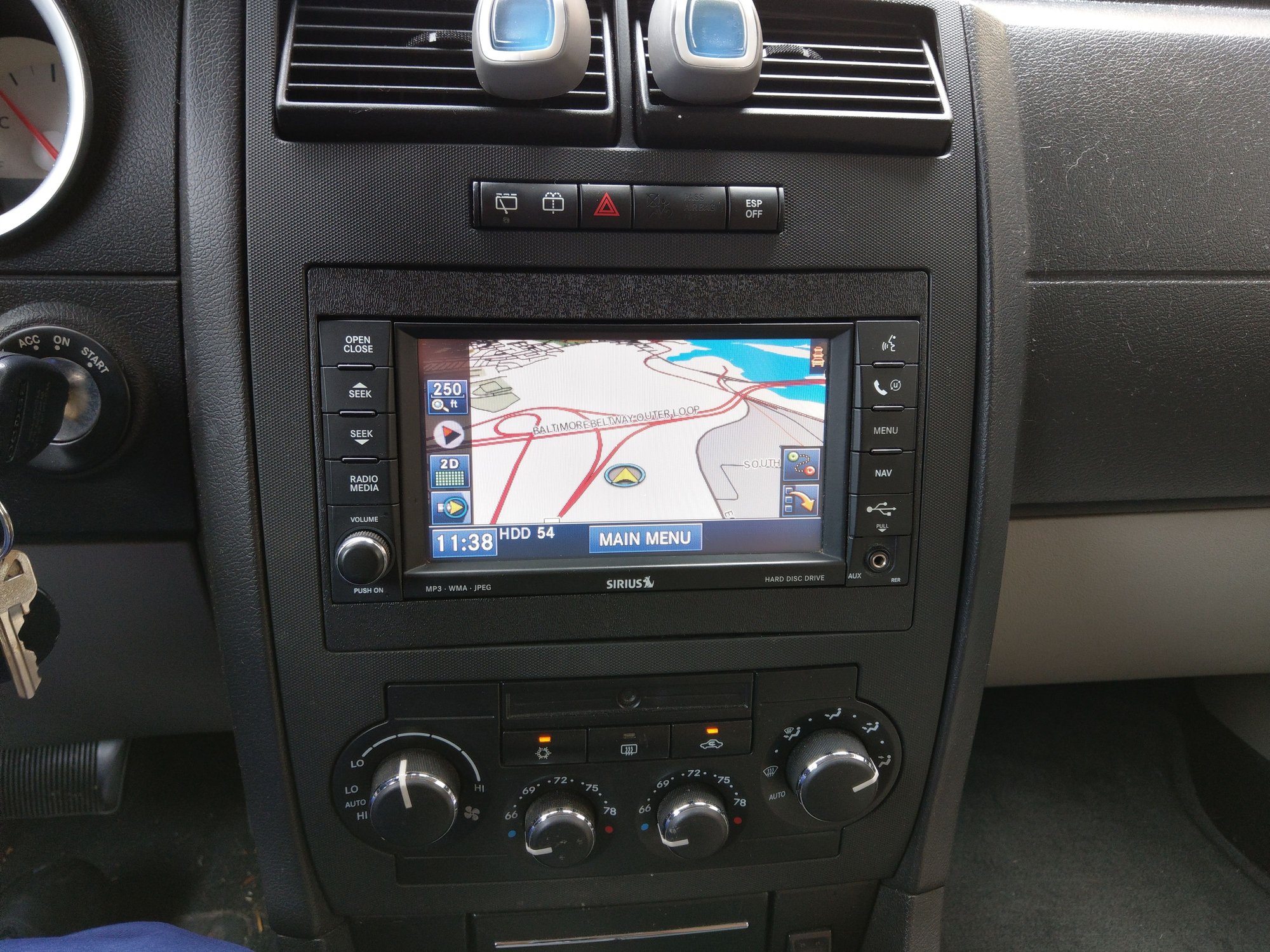

Also have a complete retrofit kit to put a newer nav MyGig in:

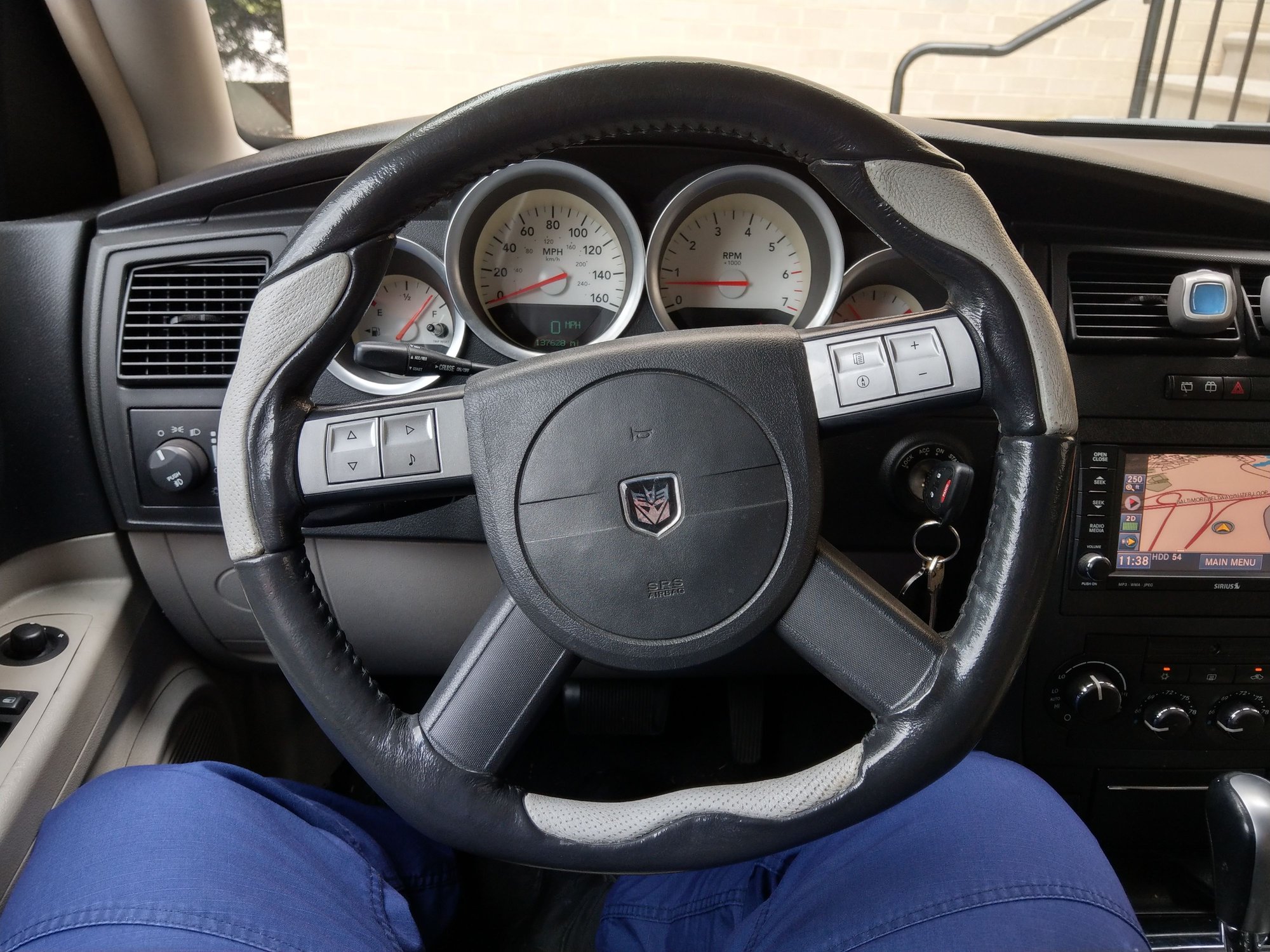

For the right price I might have a Grant steering wheel to part with (these are hard to find anymore):
