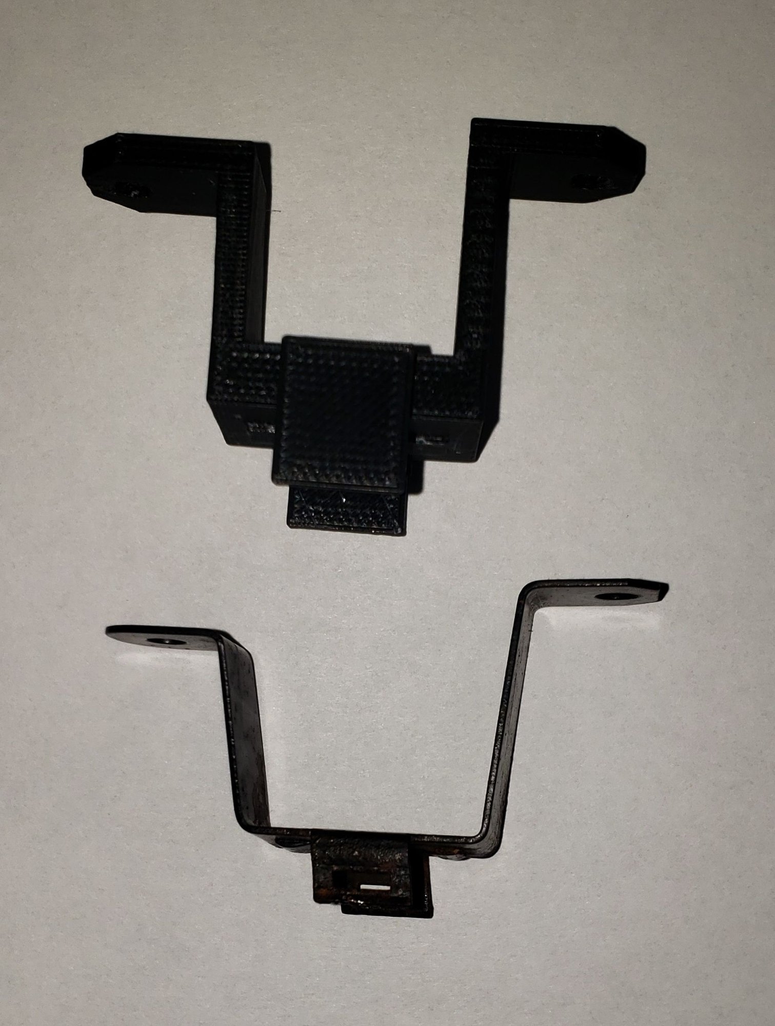

Top is the ABS part and bottom is the original clip that rusts...leaving the button to fall inside the light bar.

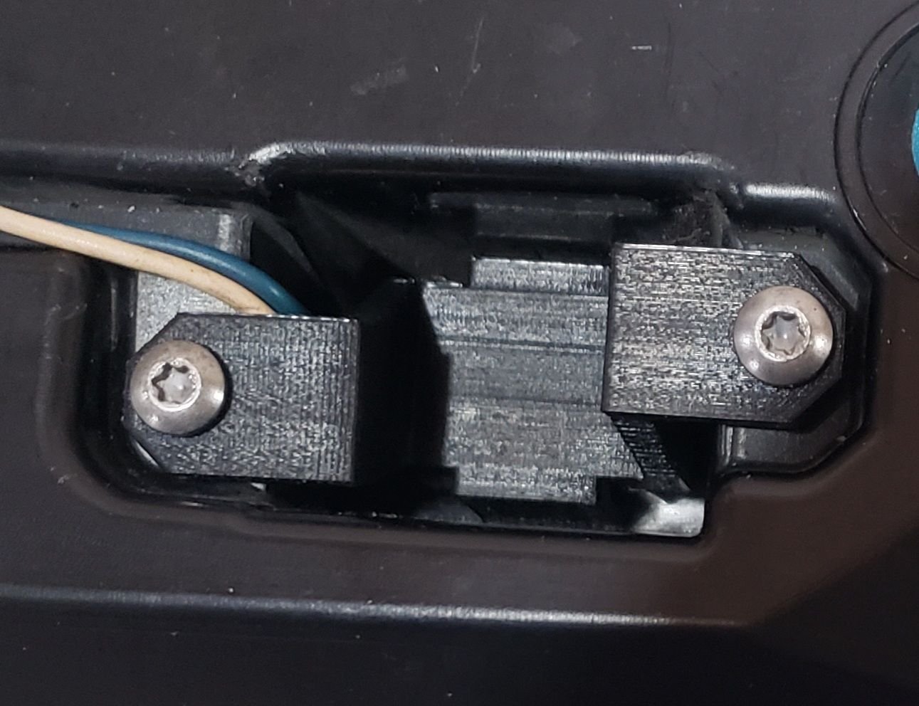

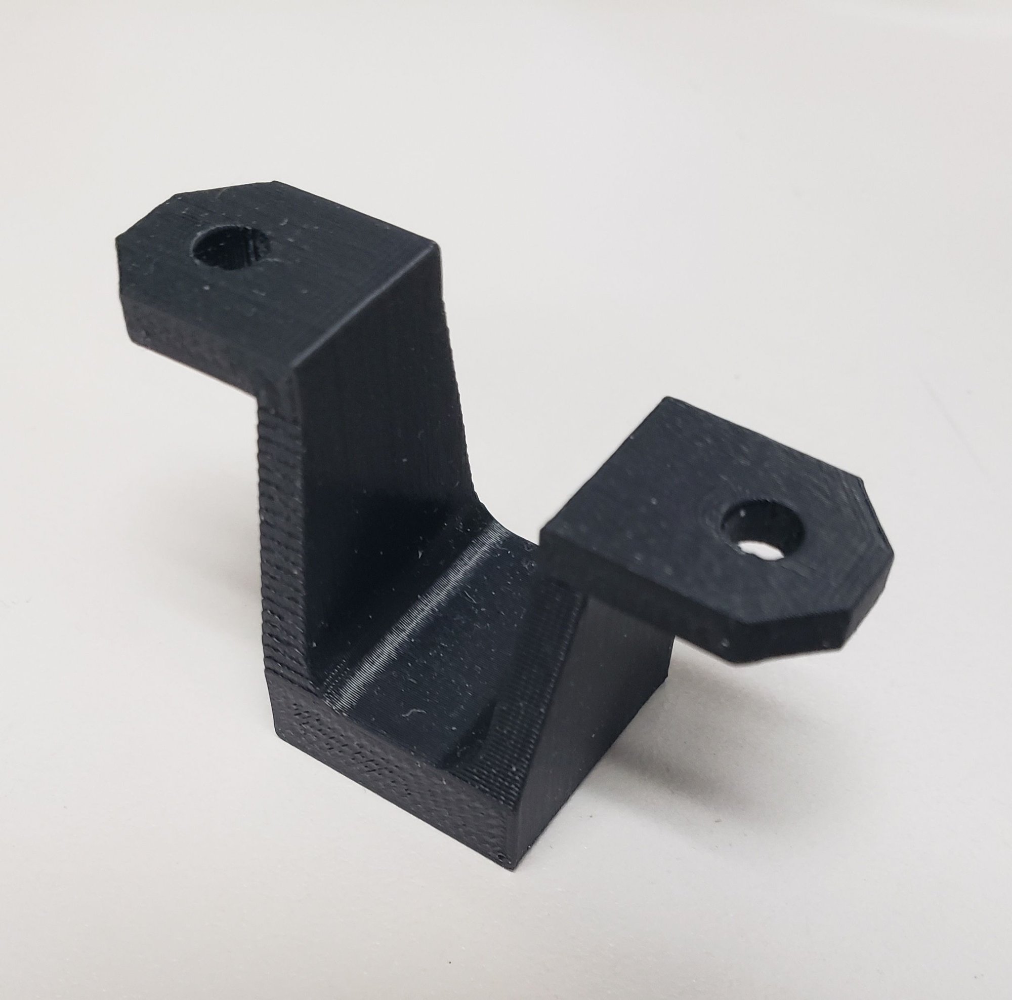

pics of the ABS bracket I have made to replace the metal one that rusts out. This captivates the actual button and holds it in place in the light bar and uses the factory screws.
